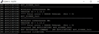

I am making Zigbee based project and I tried to use the P-Nucleo-WB55 and using STM32CubeIDE v1.15. Once I downloaded the CubeWB1.19 and compiled the Zigbee apps but none of those apps working. It always shows the Fatal Error saying Unknown, when I check the code it is checking the FW version and it is not in there so it stops.
Is there any solution to resolve this issue?

Read it and tried it, but could not do that. I put my .elf and starting address, but still looking some FW. I am not sure what to do.

I see on your capture that your are using a very old Wireless Coprocessor firmware V1.13.2. I recommend to install the latest one V1.19.0 and give it a try.
