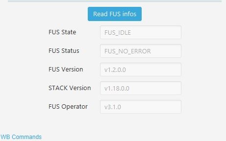

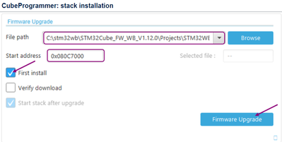

It seems that the Wireless stack firmware is not installed correctly on your device, you can check the firmware versions for both FUS/STACK directly on the STM32CubeProgrammer which gives you also the possibility to start the FUS / Wireless stack after a download complete.
Have you installed the binary at the right address following the release note document ? Could you please share a capture of your configuration on the STM32CubeProgrammer ?
You can also refer to this wiki page that describes step by step how to update FUS and Wireless stack on your device.

‎2024-01-10 9:55 PM
Here is the FUS info:

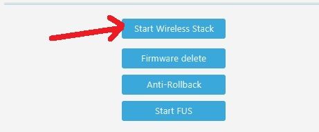

I think, I solved the problem. I had to start wireless stack. That is not mentioned in FUS update guide. Should it be application's task?

Good to know that your issue is solved.
Indeed, the start of the wireless stack after upgrade is supposed to be performed directly by the CubeProgrammer as follow :
The option Start stack after upgrade is checked by default
Starting manually the wireless stack is possible in order to verify the correct installation of the firmware, and to prevent any stuck on M0 side.
Best regards
