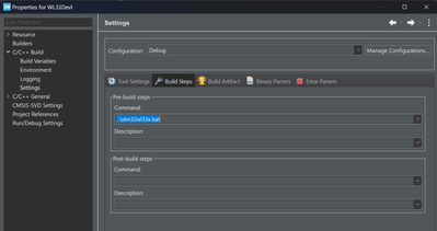

I am attempting to patch a file before building, but I have not been successful. I tried using both a .sh bash script and a Windows .bat file, and they work as expected when executed directly from their respective terminals.
However, when I run them through the STM32CubeIDE Pre-build step in the Settings, they fail to work as intended. Interestingly, the .bat file appears to execute and displays a message in the STM32CubeIDE console stating that the patch was applied. Yet, the actual file remains unchanged.

In the project setting I added the following to the Prebuild step as shown below
In STM32CubeIDE build output I get the following.
make -j20 all
..\stm32wl33x.bat
Applying patch from C:\devl\WL33Devl\stm32wl3x_hal_rcc_ex.patch...
Patch applied successfully!
Even though it is showing that the patch has been applied successfully the stm32wl33x_hal_rcc_ex.c file is not modified by the patch.

As you already presumably know, the current directory for the IDE build is the 'Debug" or "Release" directory. And your .bat or .sh file is in the project root. So you correctly run the .sh or .bat with "..\". However, the "current directory" remains the "Debug" or "Release" directory. You can verify this by echoing the current directory from the .bat or .sh file. Add a line to the beginning of the .bat or .sh to change directories up one level. Then everything else should work.

Thank you for your suggestion. Changing directory up one level in the bat file solved the problem.
