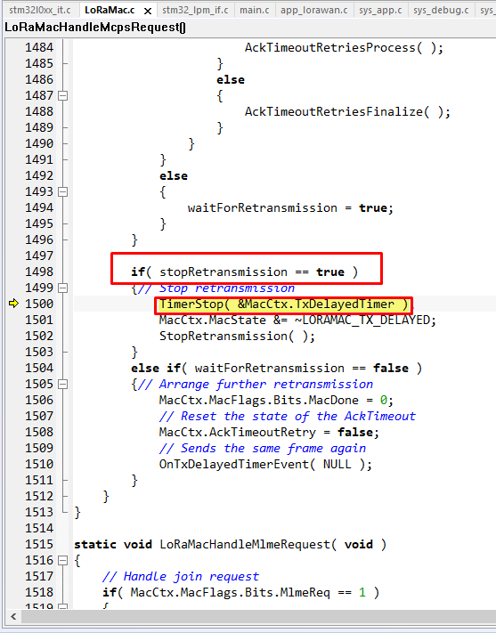

After sending the first uplink using ST I-CUBE_LRWAN 2.1.0, the application stops in the hardfault handler. It's probably an issued with the circular buffer for timers.
0693W00000NpEhSQAV.pngDid anyone else had this problem?
Thank you.

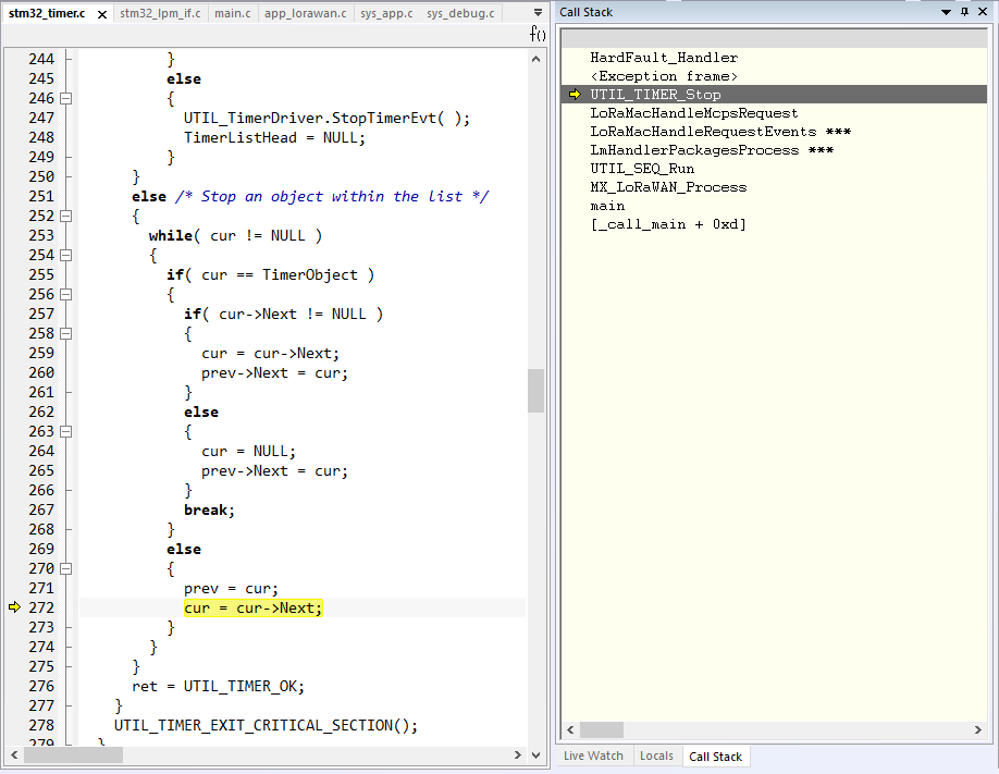

You should probably dig into what's actually happening. Look at the registers and addresses involved, and if the structure has been corrupted, or the pointer is just non-sense.
It does look to be NULL checking the pointer, but if it points to random memory, or is misaligned the line 272 statement could potentially fault as it fetches.

I'm debugging and trying to understand the error, but it seems that the pointer actually advances to a not allowed memory region, which causes the hardfault.

Well does look to be chasing a linked list.
So either some portion has become corrupted, or there's expectations the allocated memory is clear, ie calloc() vs malloc()
For GNU/GCC based tools watch how the heap is allocated, and the potential for the stack/heap to collide with very large auto/local allocations within subroutines or related call-trees.

UPDATE: I have found the problem.
After sending an uplink, the static void LoRaMacHandleMcpsRequest( void ) function in LoRaMac.c file access the timer table - by the scheduler implemented by ST in this version - to stop a timer that was not even started. This causes the hardfault.
And now a workaround will have to be implemented to solve this problem.

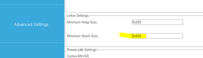

I run into the same problem while porting LoRaMAC V4.7.0 to STM32L072CZ (Murata ABZ).
Increasing the Minimum Stack Size to 0x600 solved the problem for me.
