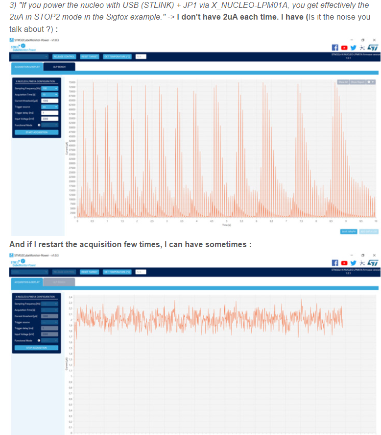

I measure : 725uA !!!0693W00000JN57iQAD.png
How in practice to measure these 2uA ?
Thank you

Hello @LLr.1​
Great !
 -> I don't have 2uA each time.
Yes please try with pull-up on PA2/PA3.
Br
Bruno

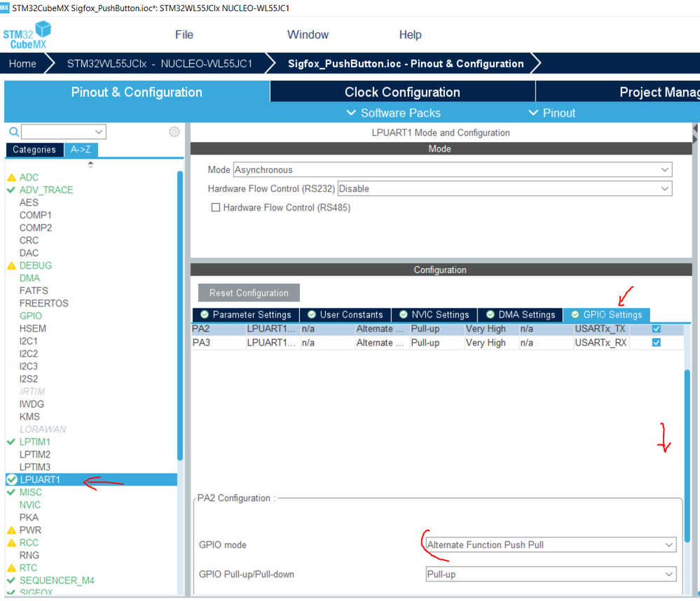

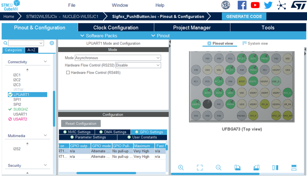

I tried to pull-up PA2/PA3 on Cube MX:
0693W00000JOrBVQA1.pngbut I cannot change the "No pull-up..." in "Pull-up". Also, What is the use of this LPUART1 ? It is not used with LoraWan end node
Bruno_ST
Please try changing in the code directly. I will check why CubeMX doesn't want to and report a tool bug if it is the case...
@LLr.1​
Please try to pull them up directly in the Code. I will check, but i suspect a CubeMX bug that i will report if it is the case.

I cannont see the classic MX_GPIO_Init(); to initialize the pins where I can do that ?
I have check there is no bug tool (CubeMX version 6.4.0)0693W00000JQ3ayQAD.pngIn the code it is in HAL_UART_MspInit().

LLr.1
Senior
Thank you,
but I have always the same behavior
0693W00000JQ4QpQAL.pngI will try an other board NUCLEO
Best regards
LLr.1
Senior
Update : it is just a problem with this board, with another board, I have the good current curve.
