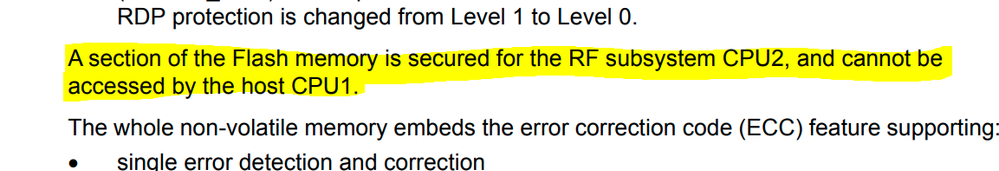

0x0806f18c is near the end of the flash.
You're probably reading FLASH that is reserved for the second core (CPU2) handling the wireless functions.
From the datasheet:
From the datasheet:
Guru
Read out FLASH_SFR to verify what's reserved for CPU2.

Makes sense. I missed that in the data sheet. Thank you.
