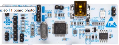

I would like to write C code for the above board.  From reading, I believe the steps are as follow.  Appreciate if you may help to see if any issue.   TIA
1. I have Nucleo F103RB (and also F401RE) to be used as ST LINK programmer
2. I did firmware upgrade to Nucleo F103 and it is now ST-LINK V2 FW : V2J42M27 Debug + VCP.  It will work right?  Although the Nucleo WL5JC board has ST Link V4.
3. I plug in the Nucleo F401 and hit the "update firmware" buttom. Current firmware is V2J43M28. It suggests to "update" to V2J42M27 Debug + mass storage + VCP.  Strange the suggest upgrade is one number *LOWER* ?
The Nucleo F103 also suggests upgrade to one number LOWER and I did it.   I have not yet change the Nueclo F401.
3. From UM1724, user manual of Nueclo F103, Remove two jumpers on CN2 connector.  CN4 will become six-pin SWD to be connected to the STM32WL5JC target board.
4. Does pin 1 on Nueclo F103 and F401 outputs 3.3 volts to power the target STM32WL5JC?

Hello @David_
1) You can do that for sure
2) The ST-Link V2 should do the job. the Nucleo-WM55JC is using the ST-Link V3 just because is the last version available when releasing this product.
3) Correct.
4) Typically, pin 1 on the CN4 connector of NUCLEO boards provides 3.3V to power the target board. However, it's always good practice to verify this with a multimeter.
5+6) You can use the Cortex-M4 alone for developing your project. A lot of examples are available on Our CubeWL
