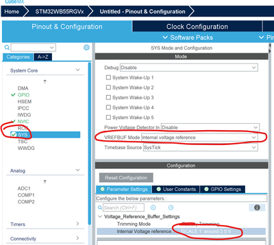

Yes, you were right. Thank you very much! Can you please tell me how to configure VREFBUF? I don't have this parameter in the cube.
The settings for VREFBUF are under SYS.
IlliaGx
I think I did it. Thank you very much!
