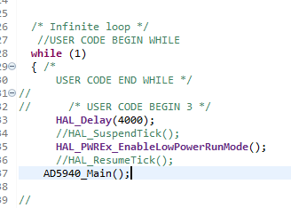

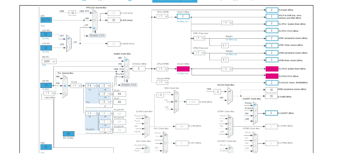

I have tried setting the system clock to MHz, enable HAL_PWR_Ex_EnableLowPowerRunMode(), setting all unused pins as analog, but there is clearly something that is holding me back. from achieving minimal current consumption. PCC suggests that using Lowerpower run mode should average out to 32.17 uA of current consumption but I'm nowhere near that now.

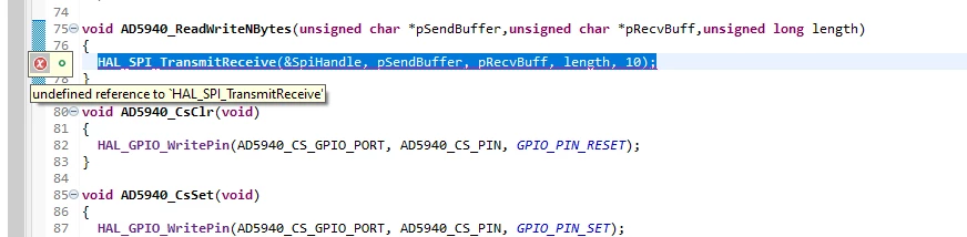

The main error I am getting is with the NUCLEOWB55Port.c file (please see attached). In BLE_Sensor the hierchary opens the stm32wbxx_hal_spi.c file but in this case it opens the .h file and give this error I can't get past. Please help.
BLE_Sensor and BLE_Heartrate seem to have pretty different firmwares in the sense of no p2p being present in the BLE_Heartrate firmware.

In BLE_Sensor I modify the p2p server app and p2p .c files along with app_entry hw_timeserver and main.c.
After several days of trial and error I was able to get it to work. I basically fused the necessary BLE_Sensor files (p2p being the most important) with BLE_Heartrate to significantly reduce the power consumption from 150 mA to 80 mA (connected to Debugger) and 80 mA to 10 mA (without debugger and just custom pcb).
It must be able to be further optimized. The lower mode enable and debug trace disable changes didn't appear to do much but I'll try again.
Any other advice on how to keep reducing the power consumption would be greatly appreciated. I have made significant strides so far.
