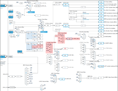

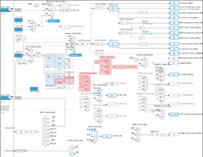

Unfortunately, neither A nor B were developed by me, and B didn't even use CubeMX and therefore it has no clock configuration diagram to look at and compare. A does use CubeMX, but A and C have identical clock configuration diagrams, apart from the RNG bit which C uses but A doesn't (marked red). That's also why I assumed C's clock configuration would be correct, but apparently it isn't.
Clock map A:
Clock map C:
I guess my only chance to find out what A does right and B does "wrong" and C does not do at all would be to look at the code, or certain registers or variables at run time. Can someone point me to the part of the setup code and the variable names that I should check, given the behavior described above?

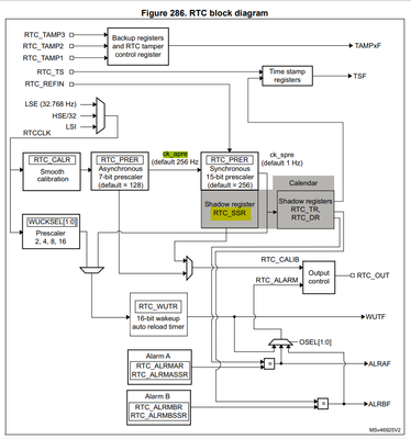

For the power consumption, accordingly to the AN4759 (Using the hardware real-time clock (RTC) and the tamper management unit (TAMP) with STM32 microcontrollers - Application note) :
STM32WB serie have a RTC2.
Have a good day.

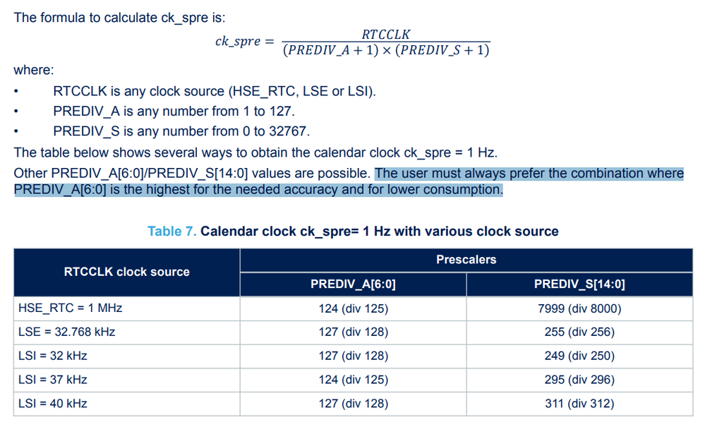

Yes, that's what I found, but also section 2.1.4 says:
But how do I chose PREDIV_A? I understand that (PREDIV_A + 1) * (PREDIV_S + 1) must equal RTCCLK. That's why 127/255 of A works, and 15/2047 of C does as well, but obviously not 15/32767 of B.
But what condition does PREDIV_A need to meet in order to have an RTC accuracy of 1ms, 10ms, 500ms, etc.? How do I calculate PREDIV_A from the needed accuracy?

The RTC accuracy depends on your input clock and his own precision. The RTC allow you to do a smooth calibration, if needed. (ref section 29.4.11 "RTC smooth digital calibration" of rm0434).
To obtain the 1 Hz input to the calendar, you can use PREDIV_A = 127 and PREDIV_S = 255. Alternatively, you can use PREDIV_A = 15 and PREDIV_S = 2047, but this will impact consumption and RTC_SSR.
The sub second register (SSR) is updated using clk_apre = 32768 / (PREDIV_A+1).
With PREDIV_A = 127 you add 1 to the sub second register each 3.9 ms.
With PREDIV_A = 15 you add 1 to the sub second register each 0.5 ms. This allows a better SSR precision.
(And with PREDIV_A = 31 you add 1 to the sub second register each 0.97 ms. Which is the config the closer to the ms).
The RTC_SSR is used to configure alarm with the millisecond precision.
