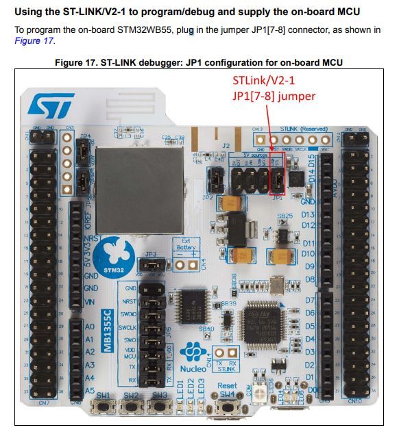

Hello @kcire L.​ ,
Make sure to upgrade the ST-LINK/V2-1 firmware and you correctly configured the jumpers.
Check your pins assignment following the Table 11. IO assignment in the UM2435 User manual for STM32WB Nucleo pack.
Make sure to use the latest CubeProgrammer tool.

I mean the log obtained by STM32CubeProgrammer, when using CLI command.
Have a look at the attached document, it maybe helpful regarding the configuration.
I think you should check in the device management if there is no problem with the ports, and try to disconnect the port in device management and reconnect.
Check if all jumpers are correctly configured :
  • set correctly the jumper JP1 ([7-8] on USB STL).
  • JP2 is ON
  • JP3 is ON
Imen

I have the exact same problem. And I am a fairly experienced STM32 user. Yes, JP2 and JP3 are on. Yes, JP1 [7-8] on. Yes, the red LEDs are on. Yes, the latest driver, and I can see it properly in my Window's device manager. Yes, the lastest CubeProgrammer version. I was also trying to load the Heart Rate example.
