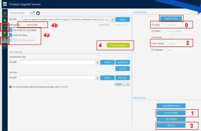

Hello @majidsurefow
Could you please try to follow those steps:
[0] Check FUS v2.1.0 installed.
[1] Before new stack install, force previous stack delete
[2] Check Stack version. It should be v0.0.0 (when deleted).
[3] Push "read FUS infos" or "start FUS" to force FUS running mode.
[4] Perform "Firmware Upgrade" with all options enabled:
Finally, verify Stack correctly installed by checking version with read FUS infos.
If an issue acquires after step 5 or 6, please disconnect and reconnect the board.

I answered my question, i think.
Firmware is 130,100 bytes long, or 0x1FC34.
With FUS starting at 0x080EE000, i needed to back out more for my start address for the BLE Stack. With a start address of 0x080CA000, i was able to upload the new FW.
Stack version v1.22.1.1 is now flashed.
