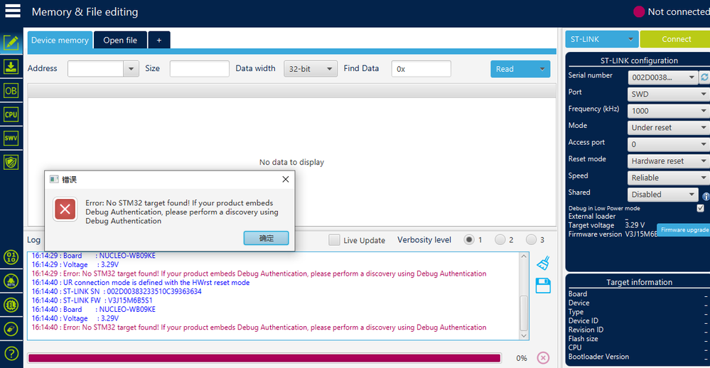

I have confirmed that the ST-LINK SWD connection is normal. When I pull up BOOT, I can download the code normally

I have already upgraded st linkv3,but Before and after upgrading again,I still can't connect to the NUCLEO-WB09KE
2024-09-30 2:22 AM
My other boards can connect and recognize normally
2024-09-30 2:30 AM
have you updated the stm32cubeprogrammer program? which version are you using?

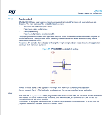

For your information, the application, which is programmed during production, activates the low-power mode, so the SWD port is no longer accessible after the board is booted. You therefore need to follow the UM of this board, see below for a screenshot of the UM.

I have reviewed this document,
1. I pulled up the boot, ST link v3, but still generated a fail. txt file
2. I configured the program to enable SWD, but even after pulling up the boot and downloading it, it still generates a fail. txt file

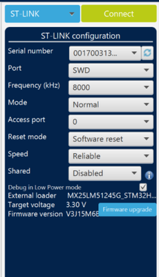

I can see from your screenshot that the stlink version you used is not the most recent version available on the ST website. Can you use the link above? you will need the latest version of the stlink utility: 3.15.7
