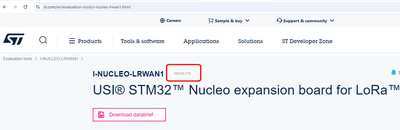

The  I-NUCLEO-LRWAN1 is obsolete:
It's likely that both the ST examples and the networks have moved on ...

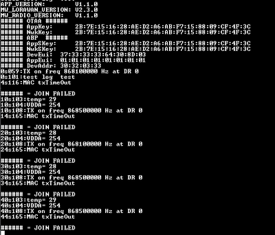

I fixed the UART, and the project is now active. It logs correctly, but the LoRa module does not physically transmit, and I can't figure out what the error is.
The UART output should show you what the code is doing - and where it's failing.
I am using this project "STM32CubeExpansion_LRWAN_V2.1.0->Projects\NUCLEO-L073RZ->Applications->LoRaWAN->LoRaWAN_End_Nod->STM32CubeIDE->sx1272mb2da"  and it is log
s
So your join is failing.
Are you sure your credentials are all correct, frequencies correct, and your network supports the join type you're using?

I am monitoring the gateway log and using other receivers to try to capture the moment when the transmission occurs.
Perhaps try sniffing the AT Commands & responses between the Nucleo-L073RZ and the I-NUCLEO-LRWAN1 ?
