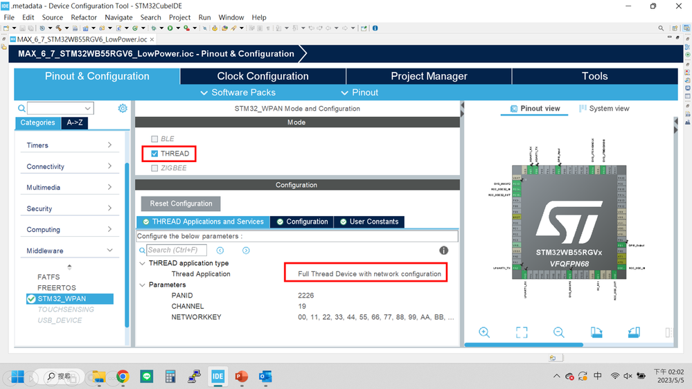

I created a thread udp project through the official Max 6.7 version of the IDE and applied it to two Nucleo -STM32WB55 development boards for thread data transmission.
(One as FTD equipment, one as MTD equipment)​

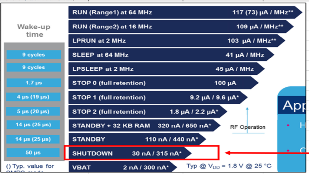

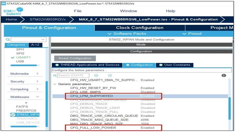

I want to let the MTD device enter the low power consumption mode when the device is idle. I try to set the low power consumption setting under MAX IDE.
After setting the above functions, the measured current consumption on the MTD device has not dropped below 1uA. How can I adjust it to achieve the Shutdown low power mode consumption effect on the file?

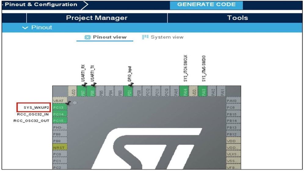

_legacyfs_online_stmicro_images_0693W00000bjRvWQAU.pngIn addition, how to wake up the device through PC13?
