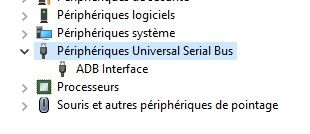

In the USB device manager I see that "ADB interface".

So you did a failed upgrade?
Is the ADB Interface device the ST-LINK/V3 ?
If it's not in Device Manager as an ST-LINK not much hope of other apps "finding" it.​

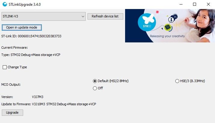

Good update : i've tried with a new cable and got this error : I've done this update before the error above :
‎2022-10-24 6:09 AM
Hello @BNamu.1​,
Based on the screenshot you shared, an update is required again. You can click on "Upgrade" to update the ST-Link FW and solve the issue.

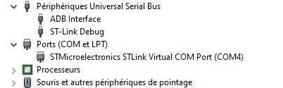

‎2022-10-24 6:10 AM
@ChahinezC​

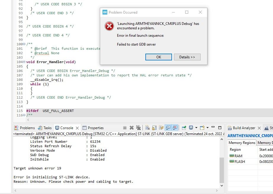

I have done this upgrade , i got this error now :
‎2022-10-24 9:33 AM

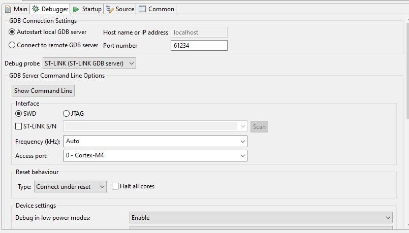

Check that it's actually usable in STM32 Cube Programmer, it's a stand-alone programmer.
This is complaining about chip level connectivity, might be due to low power modes, or interface circuitry being powered down.
Try other connectivity options, like "Connect Under Reset"
‎2022-10-24 9:34 AM
The ST-LINK/V3 uses USB-HS it's significantly less tolerant of low quality, shielded, cables.
