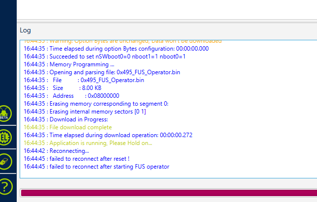

No issues flashing STM32WB55 M4 via STM32CubeIDE but cannot flash coprocessor with BLE stack with STM32CubeProgrammer.
  • September 9, 2022
  • 19 replies
  • 7142 views

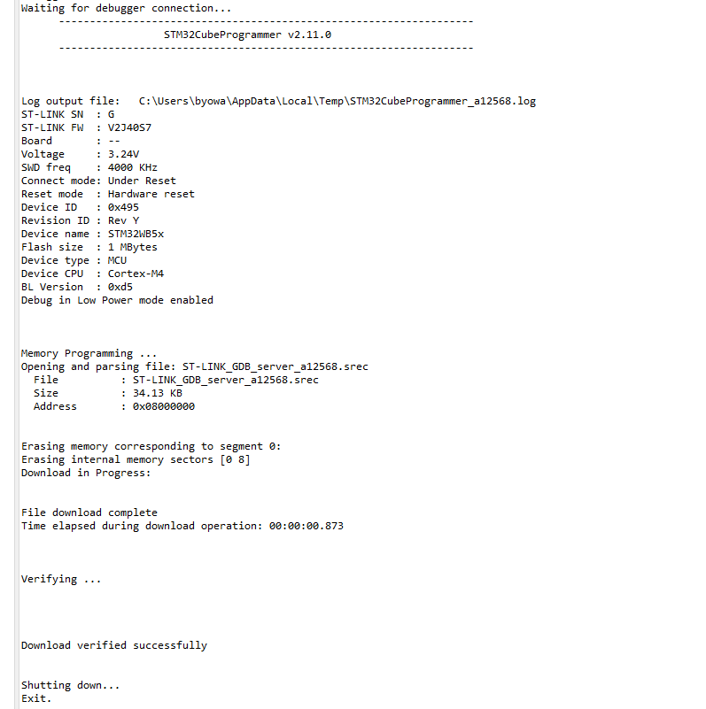

Here is the output of STM32CubeIDE on flashing the custom board:

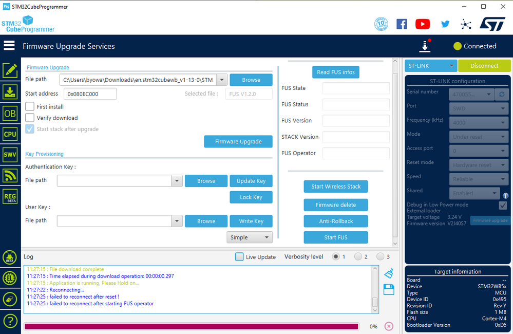

On STM32CubeProgrammer I am not able to consistently get a connection (by hitting the connect button).
There are some instances if the configuration is set to "Shared" mode that the device connects but there is no way to write/read to the FUS or perform any flashing.

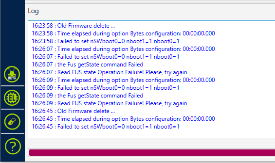

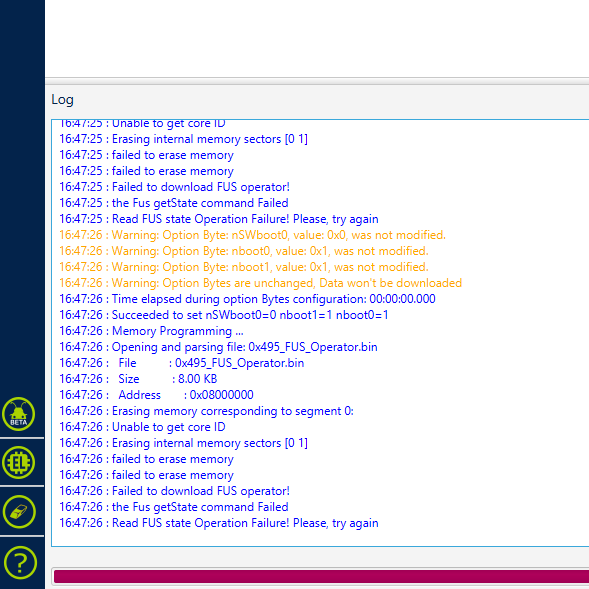

Here's some screenshots of the outputs I've seen while attempting to write to the FUS using Programmer:
I've had a hard time figuring out how to approach debugging this issue since I have not been able to get consistent results.
Any advice or suggestions is much appreciated, thank you.

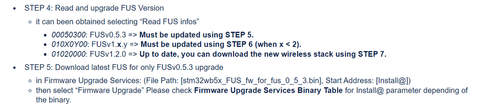

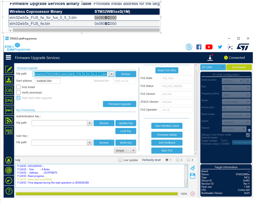

How to flash the Wireless Coprocessor Binary via SWD/JTAG by ST-LINK (STM32CubeProgrammer GUI)
Inside the below procedure, the references to binaries name and install address are provided in the section Main Changes of this file.
STEP 1: Use STM32CubeProgrammer GUI
Version 2.7.0 or higher.
It gives access to Firmware Upgrade Service (FUS) (AN5185 : ST firmware upgrade services for STM32WB Series.) through Bootloader.
It is currently available as Graphical User Interface (GUI) mode (or Command Line Interface (CLI) mode).
STEP 2: Access to SWD Interface (system flash)
For P-NUCLEO-WB55.Nucleo :
Power ON via ST-LINK and Jumper JP1(USB_STL)
For P-NUCLEO-WB55.USBDongle :
remain switch SW2 to Boot1
Connect P-NUCLEO-WB55.USBDongle
For STM32WB5MM-DK :
Power ON via ST-LINK and Jumper JP2(USB_STL)
open STM32CubeProgrammer GUI and select “ST-LINK�?
in ST-LINK configuration: (Port: SWD) then select “Connect�?
STEP 3: select “Start FUS�? in Firmware Upgrade Services
STEP 4: Read and upgrade FUS Version
it can been obtained selecting “Read FUS infos�?
00050300: FUSv0.5.3 => Must be updated using STEP 5.
010X0Y00: FUSv1.x.y => Must be updated using STEP 6 (when x < 2).
01020000: FUSv1.2.0 => Up to date, you can download the new wireless stack using STEP 7.

Seems FUS cant reconnect to Programmer app. Try change config to shared disabled .
MSuva.1
MSuva.1Author
September 12, 2022
If I have shared disabled then there is no communication.
0693W00000SvAfeQAF.pngPressing "Connect" in the above window with Shared set to "Disabled" yields no response from the software.

Can you try to connect using STM32CubeProgrammer with the following parameters:
Then try the following steps:
> Perform a full chip erase
> Start the FUS
> Read FUS
> Perform a FUS upgrade
If it's not working, can you share the log from STM32cubeProgrammer with verbosity level at 3 and the option bytes configuration ?

I am not able to connect to the board at all with the "Shared" option set to Disabled. It has to be enabled or else pressing connect does nothing.
How would I go about exporting the option bytes? Or should I just take screenshots of the option bytes tab?
Thanks
Remy ISSALYS
September 28, 2022
According to UM2237, the "Shared" option allows connection of two or more instances of STM32CubeProgrammer or other debugger to the same ST-LINK probe. So, if you can't connect to the board when the "Shared" option is set to Disabled, maybe your board is connected to another software.
Yes you can take screenshots of the option bytes tab.
Best Regards
MSuva.1
MSuva.1Author
September 28, 2022
It isn't connected to other software. I do not have this issue with my Nucleo-stm32wb55 dev boards which I assume would exhibit the same behavior if there was other software interfering.
