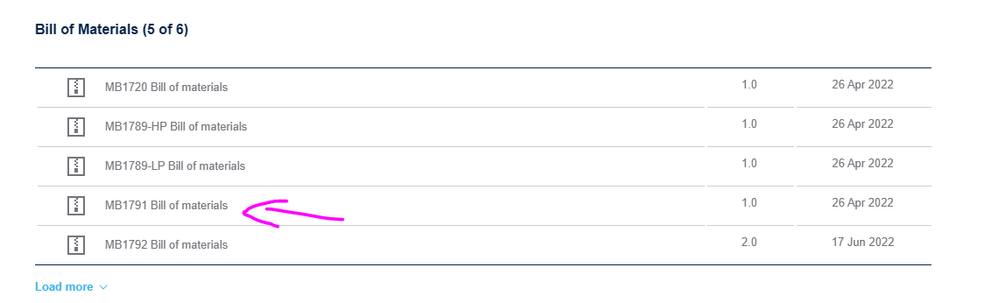

For MB1791 Development Broad, there are 3 Type of design:

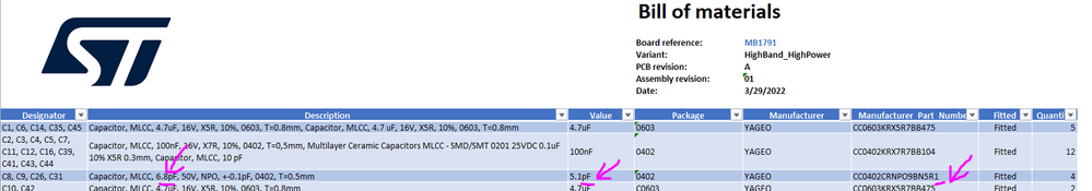

But I doubt the BOM given, the part Description, Value and Manufacture Part Number are not tally for the Location: C8, C9, C26, C31:.
Pls advise the correct value for MB1791-HighBand_HighPower.
Thanks.

2024-06-06 4:57 AM
Hello @KKan.1,
Thank you for your input, the updated corrected BOM is on-line:

2023-04-17 3:50 AM - edited 2023-11-20 8:59 AM
Hello again @KKan.1,
As mentioned earlier, documents will be updated soon with the right values, but I can inform you that the recommended value of C8, C9, C26, C31 is 6.8pF as it is mentioned in the board schematics:
Hope that helps!
2023-04-17 5:21 PM - edited 2023-11-20 8:59 AM
Hi Sara,
Thanks for feedback.
For my understanding, Schematic is general for the 3 different Band & Power reference.
BOMs is the actual that we need to follow :
Pls advise.
2023-04-19 3:59 AM
Hello again @KKan.1
Indeed, the BOM will be updated with the correct value 6.8pF, so you can safely use it before the update!
Hope that's clear!
