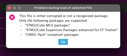

Then when trying to install the I-CUBE-LRWAN packeage into CubeIDE it gives the following error after selecting the zip package:

Hello @KMill
For the I-Cube-LRWAN, it is not compatible with CubeMX. You can't add it to CubeMX and use directly throw it. You should add it manually to your project.
Best Regards.

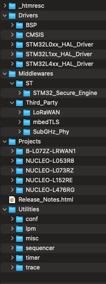

I download the ZIP and extract it.
It contains a bunch of folders, and drivers, and all kinds of goodness, which looks exactly like the structure of an expansion pack. Which are normally added via "Manage embedded software packages"
What it does not conatin is a bunch of source files.
I must have missed some detail on how to work with these expansion packs, which is why it would benefit from a read.me at least. Or I need to go back and learn what I missed!!
Hello @KMill
The available support is the UM2073 that should be really helpful for the first steps. For the implementation, I think you should follow the implementations of the examples already available on the package.

I have read that doc already, it's full of great detail on the devices and the package capabilities, but nothing about how to actually integrate the package into a new project. I'm sure it'd something simple I've missed.
Just try to follow one of the Examples and how the functions are integrated there and that should do the job for you.
