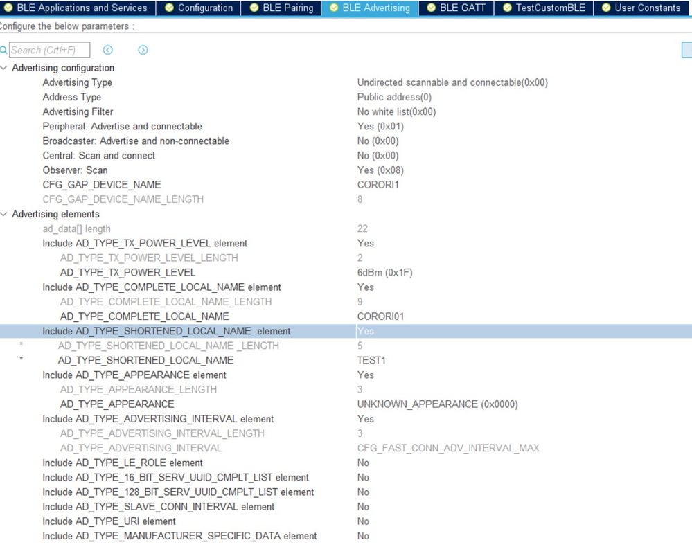

In STM32_WPAN -> BLE Application and Services, if Custom Template is Enabled, several new tabs appear:
BLE Pairing
BLE Advertising
BLE GATT
In the BLE GATT window, you can add new services. As you add a new service, you also get a new tab with the name of the service.
I have no problem with this, and it seems like a good way to approach setting up services. However, this has been present for at least 3 releases of the MCU package and still does not work. There is also literally zero supporting information (that I can find) on these changes. An update of the MOOC would go an awfully long way to making this functionality useful.
In the BLE Advertising tab, it seems to default to everything turned off. By turning bits on, it allows you run the code generation, and creates a variable "ad_data[]" int app_ble.c. This seems to replace the "manuf_data[]" variable used in the P2P server modes, but also used in the MOOC example on modify a BLE profile.
Unfortunately, trying to fill in the various entries on this tab cause the code generation to fail in a couple of different ways:
- If you include "AD_TYPE_SHORTENED_LOCAL_NAME", the generated entry in ad_data[] is "valueNotSetted, AD_TYPE_SHORTENED_LOCAL_NAME , 'T', 'E', 'S', 'T', '1', //Shortened name"
Looking at the other entries, it looks like the first value (which is valueNotSetted, and "Setted"? Really?) is actually the length of the entry plus 1, so it should be 5 in the CubeMX view, it does show "5" in the LENGTH field, but this doesn't make it into the code.
If you include AD_TYPE_ADVERTISING_INTERVAL, you can't change any of the settings (it is set to CFG_FAST_CONN_ADV_INTERVAL_MAX), the generation process seems to fail completely, although you don't get any outward error messages or feedback: In app_ble.c, 126 empty lines are empty, just after the file header, and the file ends with the following:

Fundamentally, I have two questions:
- When can we expect a version of the Cube MCU package for the STM32WB55 that works for custom BLE profiles?
- When can we expect an update to the documentation/tutorials/MOOC that works with up-to-date tools?
There are other issues with the BLE setup (e.g. I can't define all 128 bits of a UUID, even I select it), but the above questions are more fundamental I think.

There was significant progress made in CubeMX v6.2.0 + STM32CubeWB_v1.11.0, in terms of generating a project that works out of the box. Since CubeMX v6.2.0 now handles the IPCC, you'll have to enable the peripheral and enable the associated NVIC interrupts. There's still a couple of the missing pieces though that didn’t make it in this version, so, with CubeMX v6.2.0, you still need to make the following changes manually in the code, if you were to generate a code project from the attached basic .ioc project:
1) In main.c, add the UTIL_SEQ_Run( UTIL_SEQ_DEFAULT ); call in the main() while loop + the #include "stm32_seq.h"
/* Infinite loop */
/* USER CODE BEGIN WHILE */
while (1)
/* USER CODE END WHILE */
2) In stm32wbxx_it.c, modify RTC_WKUP_IRQHandler() to call HW_TS_RTC_Wakeup_Handler(); instead of HAL_RTCEx_WakeUpTimerIRQHandler(&hrtc);
void RTC_WKUP_IRQHandler(void)
/* USER CODE BEGIN RTC_WKUP_IRQn 0 */
/* USER CODE END RTC_WKUP_IRQn 0 */
//HAL_RTCEx_WakeUpTimerIRQHandler(&hrtc); //Comment this call
/* USER CODE BEGIN RTC_WKUP_IRQn 1 */
HW_TS_RTC_Wakeup_Handler(); //Add this call
/* USER CODE END RTC_WKUP_IRQn 1 */
The next release of CubeMX is expected to generate these sections of code automatically so the user doesn't have to add them manually.
