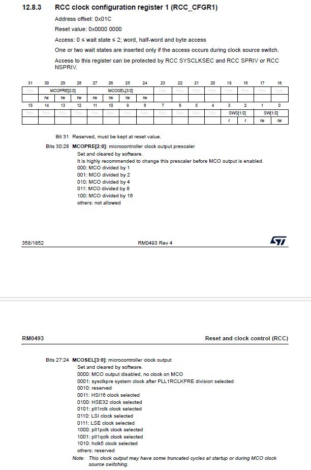

I would like to use the STM32WBA55 controller and forward the clock of the HSE to the MCO pin. The data sheet states that this is only possible for internal clocks:
Clock-out capability:
– MCO (microcontroller clock output): outputs one of the internal clocks for external
use by the application. (only available in Run, Sleep and Stop mode)
– LSCO (low-speed clock output): outputs LSI or LSE in all operating modes.
According to the block diagram (see attachment), however, this should be possible.
Best answer by MHoll.2
Yes this should be possible, see RCC_CFGR1 register MCOSEL bit's in RM0493:
Martin
Martin
Amel NASRI
September 23, 2024
Hi @ledi7 ,
To confirm the answer of @MHoll.2 , here a ready to use example: STM32CubeWBA/Projects/NUCLEO-WBA55CG/Examples_LL/RCC/RCC_OutputSystemClockOnMCO.
Check the readme file to understand how it works.
