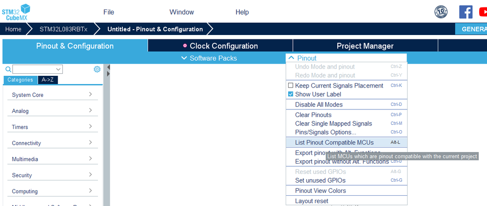

Generally speaking, In CubeMx it is possible to change MCU type:
It is maybe better to install STM32CubeMX separately than use integrated version in CubeIDE. Then there is wider possibilities to save .ioc with different name etc.
Remember to backup your project before start.
