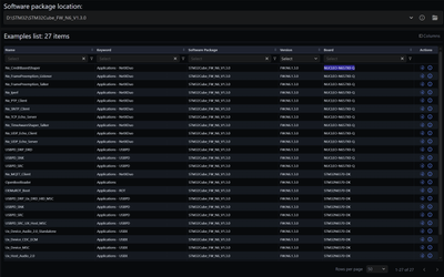

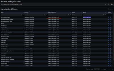

 I am trying to import the RTSP example for the NUCLEO-N657X0-Q. It is not appearing in the IDE as a choice, but I see the project in D:\STM32\STM32Cube_FW_N6_V1.3.0\Projects\STM32N6570-DK\Applications\VENC\VENC_RTSP_Server

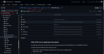

If you might not to reach examples, also you able to see from github.
I guess your wanted project this :
https://github.com/STMicroelectronics/STM32CubeN6/tree/main/Projects/NUCLEO-N657X0-Q/Applications/NetXDuo/Nx_CreditBasedShaper

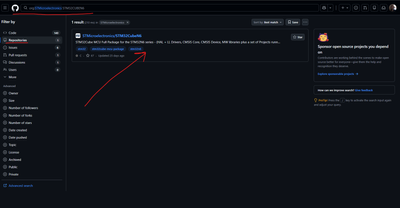

I follow this steps :
1) I find software package name
2) search them in github
3) explore projects in repository
I use CubeIDE and I have experienced the same problem from time to time. I fix that this solution. I hope I have been helpful.

Hi @mdkf,
If the project is not shown in the Examples Browser, its format is likely not supported yet.
You can still try to convert it manually using this action with D:\STM32\STM32Cube_FW_N6_V1.3.0\Projects\STM32N6570-DK\Applications\VENC\VENC_RTSP_Server\STM32CubeIDE as project source:
However, it is highly probable that you will get an error when selecting the project because most N6 projects are multi-context (also known as hierarchical), which is not supported.
Support is expected later this year.

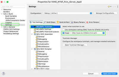

This project, like some other examples, is not compliant with GCC 14.
You must fix the GCC 13 settings in the three underlying projects to make them build.
This can be achieved via the project properties:
GCC 13 appears in the list once it is installed via the Toolchain Manager. A restart of STM32CubeIDE is required at the end of the process. Be patient: the first fetch may take a long time.
