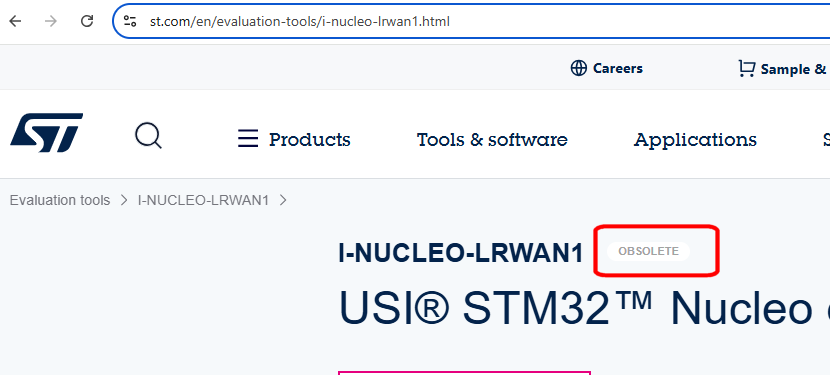

Hi all,
As part of a uni project we are developing a LoRaWAN Weather station project.
We have free access (the team is operated on a limited budget) to a I-NUCLEO-LRWAN1 board. This appears to be a very good option as the board has all the integrated sensors required, and is compatible with Australian frequency.
How good is the support and integration with current development tools, I see the suggested board on the datasheet is still currently sold (NUCLEO-L053R8).
Does anyone have experience with this board, or can point in the direction of something more suitable?
Thanks
STTwo-32
Hello @sr71brd and welcome to the ST Community.
The I-NUCLEO-LRWAN1 is an obsolete product (as you can see on the product webpage). If you are looking for a product to establish a LoRaWAN connection based on the STM32, i suggest you use the STM32WL (This series provides a portfolio of System-On-Chip solutions integrating both a low-power microcontroller and a long-range, energy-efficient sub-GHz radio (that support the LoRa transmission for LoRaWAN) on the same chip.). As a evaluation board, you may use the NUCLEO-WL55JC without a need to a host board (all in the same SOC).

As @STTwo-32 said, the I-Nucleo-LRWAN1 is obsolete:
It has been for a long time and, to be frank, the support was never great in the first place.
If you want a challenge, the schematics of the USI module can be found;  it just uses a standard STM32 and Semtech chips - so you could (in principle) write your own code...
Apart from the WL SoCs already mentioned, there is also the B-L072Z-LRWAN1 - which is still marked as Active:
https://www.st.com/en/evaluation-tools/b-l072z-lrwan1.html
