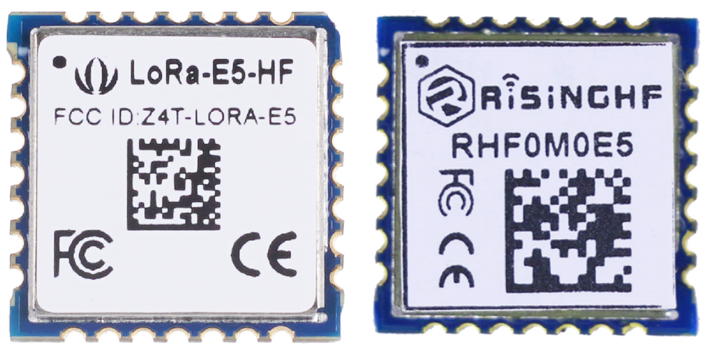

I need a good STM32WL module. does anyone know about a better choice?

Seeed LORA-E5 has STM32WLE5

What are your criteria for "good" ?
DedMoroz
I would suggest you to start with two STM32WL55JCI Nucleo boards to evaluate if you need M0 + M4 cores. You may decide that you need only M4 core and that may help you with the choice of the future module or CPU.

OFauc.1
Seeed LORA-E5 is great, but there are only a limited number of STM32WL pins routed on the module.
Donald CHAN
You can try RisingHF WL module :
http://www.risinghf.com/product/detail/24
You mean this: https://www.seeedstudio.com/LoRa-E5-Wireless-Module-p-4745.html ?
Seems it has no antenna - so will need extra design effort and approvals ...
