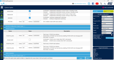

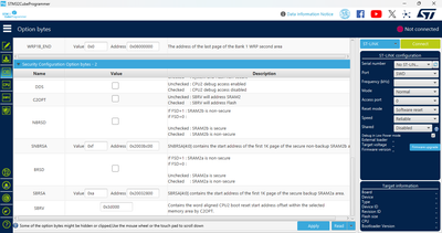

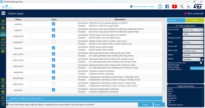

Estou usando o STM32WB55cgu6, faço a gravação pelo CLI:
I'm using the STM32WB55cgu6, I record via CLI:
STM32_Programmer_CLI.exe -c port=usb1 -fwupgrade \tmp\stm32wb5x_BLE_stack_full_fw.bin 0x080CB000 firstinstall=0
STM32_Programmer_CLI.exe -c port=usb1 -d \tmp\bootloader_110.bin 0x08000000 -v
STM32_Programmer_CLI.exe -c port=usb1 -ob rdp=0xBB -ob displ
Quando vou conectar com o USB no PC ele não conecta, meu bootloader fica piscando um led indicando que posso fazer a gravação do meu firmware pela USB, mas não reconhece.
When I try to connect the USB to the PC, it doesn't connect, my bootloader keeps flashing an LED indicating that I can record my firmware via USB, but it doesn't recognize it.
Alexandre__Promont_0-1730468388205.pngAlexandre__Promont_1-1730468958823.pngAlexandre__Promont_2-1730468994184.pngAlexandre__Promont_3-1730469019435.pngAlexandre__Promont_4-1730469041705.png

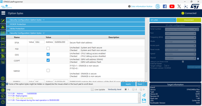

First, please write your comments in English to make it easier to understand. Also, make sure to write your SFSA value and take a picture of your board (with the USB cable in).

No problem for me, it’s easy to send in English because I use COPILOT to translate. I sent the SFSA print with the values, what is the function of the SFSA?
