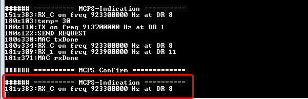

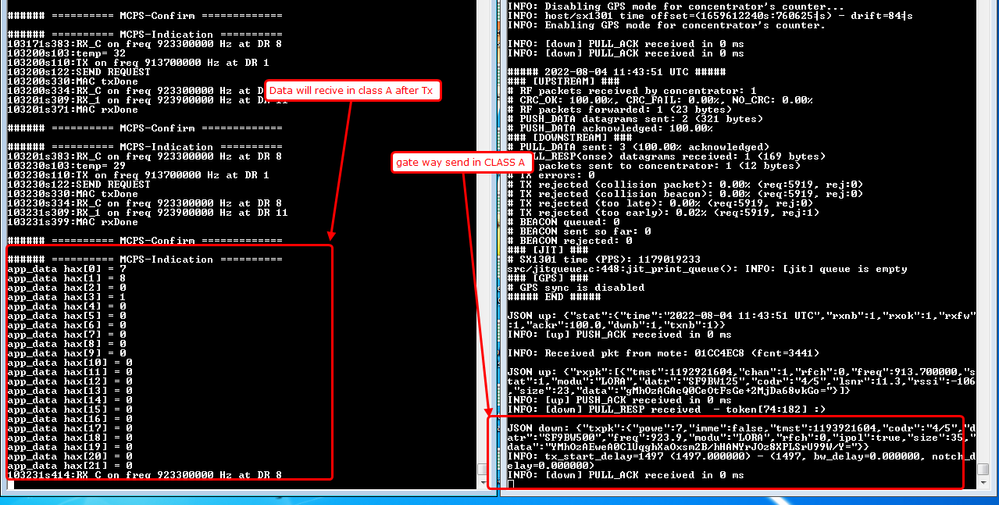

when is sent data on my module via class A it works.
In CLASS_C I expect an immediate response because the RX window is always open in class C.

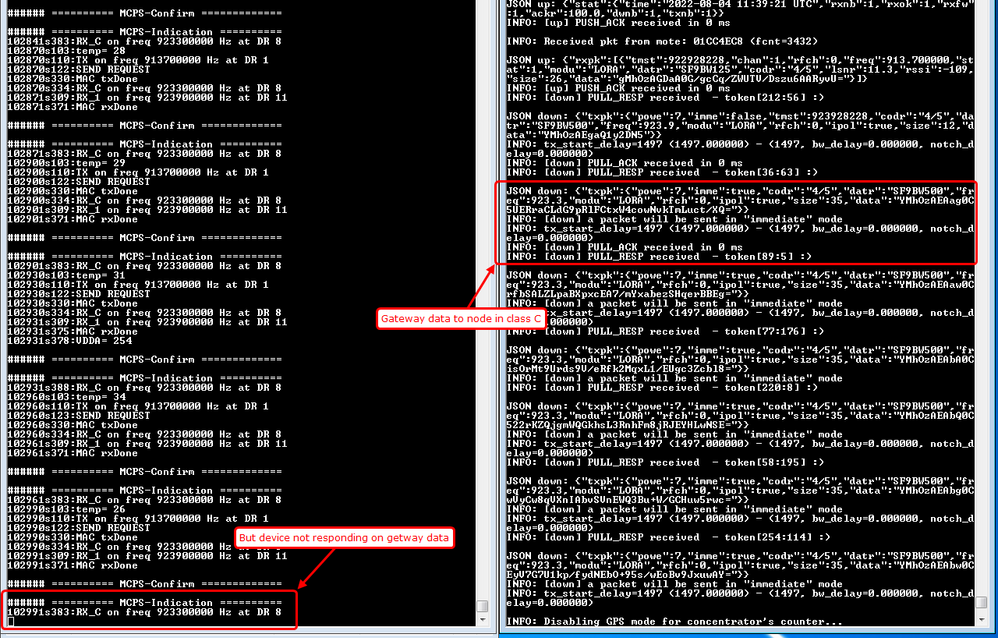

In my log, I observe that my RX window is open after TX.
when is sent data on my module via class C it's not working.
I also debug my getaway it works fine with classes A and C.
But my node does not receive data on class C.
Are there any parameters we Rely on in class C please suggest what I am missing.

>Do you have an error when you don't receive the downlink?
My node's CLASS_C Rx window will be open but I didn't get any response from the controller side. but in getaway send data to node successfully.
In CLASS_A. data received in the gateway to the node.
In CLASS_C. data not received in the gateway to the node.
I am confused because my device works fine with CLASS A but does not work with CLASS C
