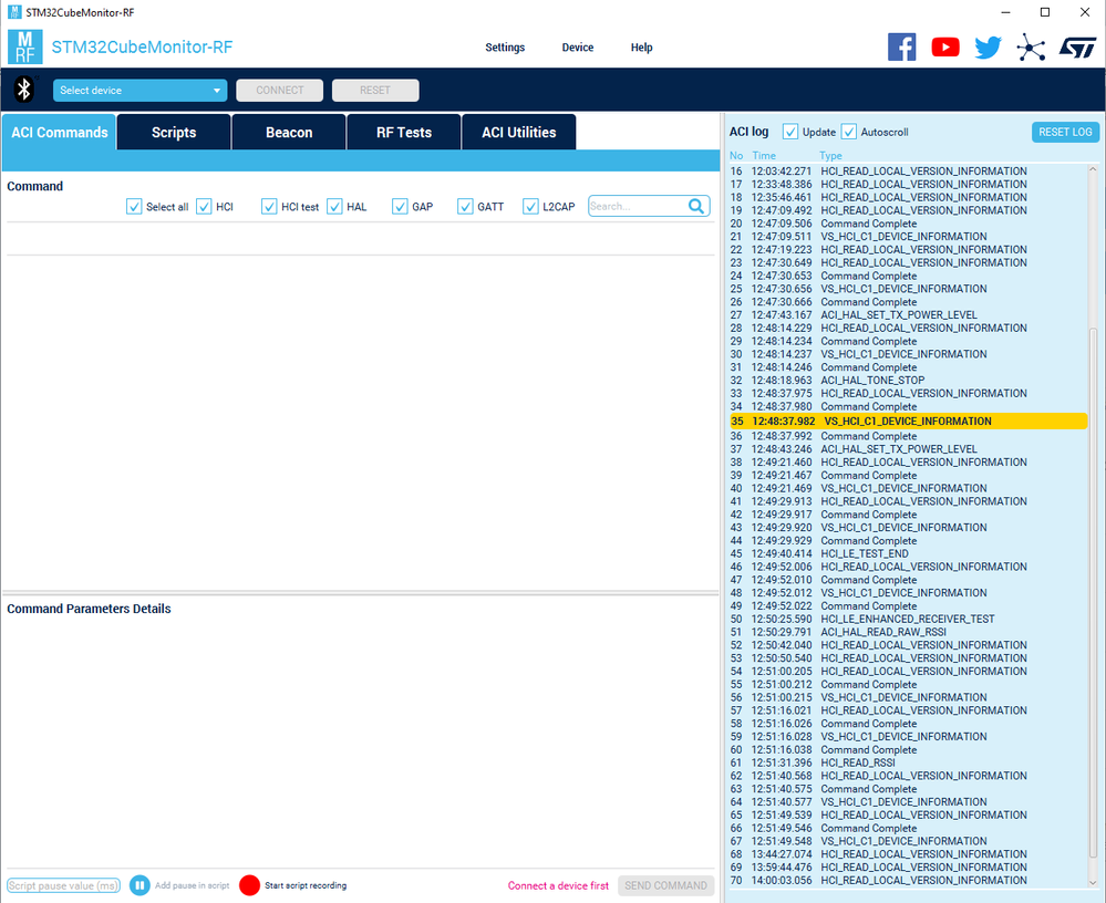

I have a self-design STM32WB board and properly flash "stm32wb5x_FUS_fw.bin", "stm32wb5x_BLE_Stack_full_fw.bin" and "BLE_TransparentMode_reference.hex" STM32_Programmer_CLI.exe. Now I am trying to use STM32CubeMonitor-RF. When I try to connect to it sometimes I receive "Device under test not responding. COM port closed". However, sometime it is connected and after some other actions be disconnected. The ACI Log is as follows:0693W000006HY0mQAG.pngCan anyone help me to resolve this problem?

In the screenshot, it seems that some command are sent, but there is no reply from the board. Line 52,53,54, the commands is repeated 3 time, but it seems there is no answer for the 1st and 2nd. After few seconds without answer, the software disconnect the port com and displays the pop up.

After commands in lines 52 and 53 I received error "Device under test not responding. COM port closed." Then, when I repeat it in line 54, the board respond command. But disconnect again and I received error again.

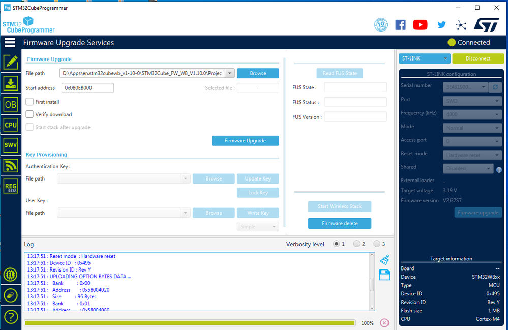

I also checked my board in STM32CubeProgrammer software. As shown in the image below, I can not read FUS state. Is there a problem with FUS?0693W000007B3k2QAC.png
