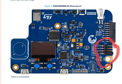

As @TDK said, you have to make sure that you are using the CN11 (USB STLK) and not the CN6 (USB USER). Also, you have to Make sure that the jumper JP2 is connected to the USB ST:

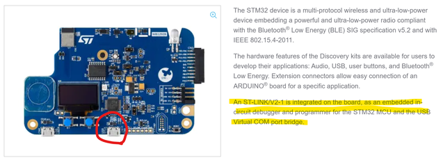

The STM32WB5MM-DK board has an on-board ST-Link/V2-1. Make sure you are connecting the st-link USB port and not the user USB port. Make sure your USB cable has data and is not power-only.
