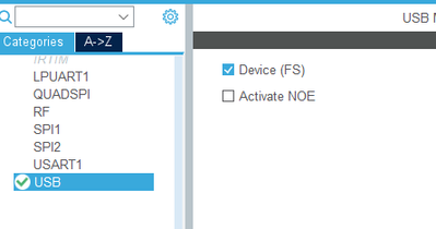

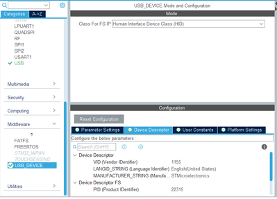

I got a NUCLEO-WB55RG board and was trying to program it as a HID device. I have configured the STM32CubeIDE and have uploaded the code to the board. Yet, when I tried connecting the User USB, it unfortunately didn't work. My computer did not recognize it as an HID device. I have switched to USB MCU on JP1.
Please help!!! Great Thanks!

Hello @Miooo and welcome to ST community
First, to verify that your STM32 is OK
can you try to run this firmware example it should make your STM32 behave as a mouse
Hope that helps you solve your issue
Gyessine
Keep it powered through the st-link connector and try again. So you will have 2 cables connected. If it doesn't work, debug the code and see where it's at.
