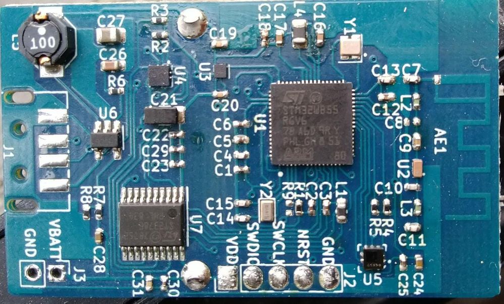

(1) We use our own custom board with the STM32WB55RGV6, we want to test the radio.
Question:
Is the CPU2 CM0+ already programmed with the "stm32wb5x_BLE_Stack_fw.bin" from the factory?
I have tried to download the "stm32wb5x_BLE_Stack_fw.bin" using ST-Link Utility and with assistance of a STM32WB Nucleo board, with address: 0x080CB000. The firmware download process was successful, no error message shown.
(2) We have tested the board, by downloading a blink LED firmware to the CPU1 CM4F, it works well.
(3) We also have tried to download the example "BLE_HeartRate" firmware, but the BLE is not detected by the ST BLE Sensor Mobile Application and by the ST BLE Profile App.

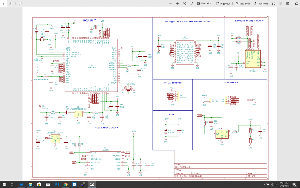

‎2019-03-22 7:28 PM
The schematic is as below:

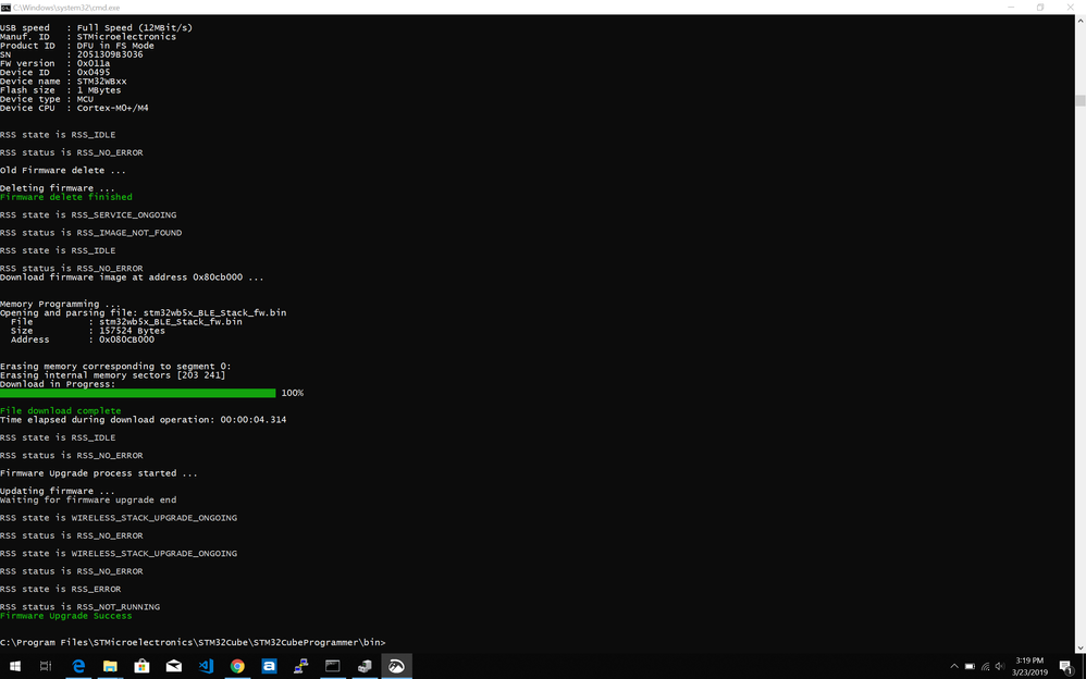

To update the firmware on CPU2 CM0+, do the following:
(1) Connect the Boot0 pin to VDD
(2) Using command line: STM32_Programmer_CLI.exe -c port=usb1 –fwdelete
(3) Next, write command:
STM32_Programmer_CLI.exe -c port=usb1 -fwupgrade stm32wb5x_BLE_Stack_fw.bin 0x080CB000 firstinstall=1
Result:
After that:
(1) put back the Boot0 pin to low (pulled down by 10K resistor to GND)
(2) connect to Nucleo board's ST-Link (SWDIO, SWCLK, NRST, GND, VDD 3.3)
(3) Use ST-Link Utility to flash the CPU1 CM4F with BLE_beacon binary
Check using ST BLE Sensor app, the beacon is still not found.
Any further analysis ?
