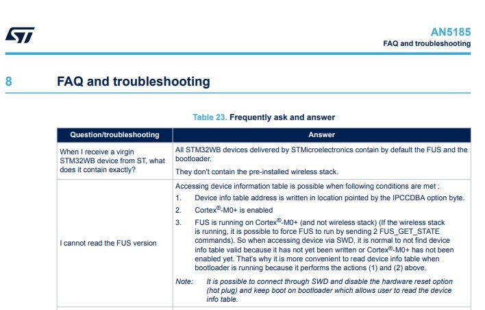

Hello @MPian.1​ ,
To identify the FUS version, you need to read the shared table memory in SRAM2a. This is explained in the AN5185 in the section 1.6 Shared tables memory usage and in Section 6.1 Shared tables usage.
Hope that answers your question!

I have same question with my new received Nucleo-64 STM32WB55 board. I am new to the ST chipset.
I start with st web site https://www.st.com/en/evaluation-tools/p-nucleo-wb55.html and watched the first video "How to program a STM32WB55 with STM32CubeProgrammer ". The usage of STM32_Programmer_CLI.exe is shown in the video and showing erase the board first. Before I erase image on the board, I would like to know the FUS version in the board.

I have images with version STM32Cube_FW_WB_V1.13.2. I really would like to know the version on the board I received. Please recommand a tool to do the job and steps to get the job done.

‎2022-04-27 8:49 AM
Issue is solved with STMCubeProgrammer tool (v2.10.0). See https://www.youtube.com/watch?v=1LvfBC_P6eg&t=314s at 3.25m.
