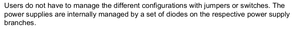

Hi all,
Can anyone explain the way to power the board with batteries?
I am trying with a small LED blink application. The board is working fine with the St-link power but not working with the batteries.
The above image is taken from the user manual of the same board. Where I am doing wrong?
Not seeing any images
"If the board is supplied by CN13, by battery or by CN11, SB37 must be removed to release the RESET pin managed by ST-LINK. In that case the ST-LINK is no more powered."
https://www.st.com/resource/en/user_manual/dm00329995-discovery-kit-for-lorawan-sigfox-and-lpwan-protocols-with-stm32l0-stmicroelectronics.pdf
Thank you for the reply...
But I don't want to ST-Link to be removed so I thought it is fine if I don't remove SB37.
The missing image is there below. this statement is right above the statement you shared.
I have gone through the schematic and I tried Closing (Fitting) the SB5 and it worked. Is it a bad approach?
Its less about powering, and more about not letting the ST-LINK clamp the device in reset.
The ST-LINK SWDIO/SWCLK pins are still connected.
