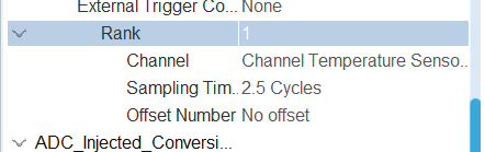

Am I supposed to use one rank per channel?
How do I add a rank using the .ioc file ?
Thank you
raptorhal2
Lead
Am I supposed to use one rank per channel? Yes
How do I add a rank using the .ioc file ? Add it to the initialization source code
Also - use a much larger sample time for temperature. Internal voltage signal sources have a high impedance.
Cheers, Hal

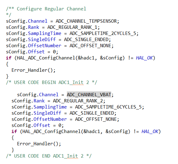

Just to be sure, I add the configuration of the rank 2 (for example) that enable my channel VBAT as shown in this picture ?
raptorhal2
Lead
Yes, but if the initialization is sequenced like this, you don't have to repeat intialization of structure members that don't change from the last rank.
For internal channels, see the example internal channel projects available for recommended sample times. They are typically much higher than what you are using.
Find a DMA ADC example to follow for two or more ranks.
Cheers, Hal
