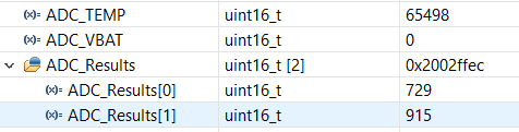

I am using a p-nucleo-WB55 and I am trying to use DMA to read two internal channels :
- Internal temperature sensor
- Vbat
Here is my code :

The value that I get are not good and I think maybe it is a calibration issue
Results :
0693W00000QO42rQAD.png ADC_TEMP should be between 25 and 30 and ADC_VBAT should be at 3300.
Had you once this issue ? Do you know what could be wrong ?

> uint16_t value
> return (value/65536)*VDDA_APPLI*3;
This is always zero, due to truncating integer division.
> __LL_ADC_CALC_TEMPERATURE
Look at that macro in Cube, check all values in that macro (in headers and subsequently reading out from the system memory), check if the ADC readout value is within the expected range.
