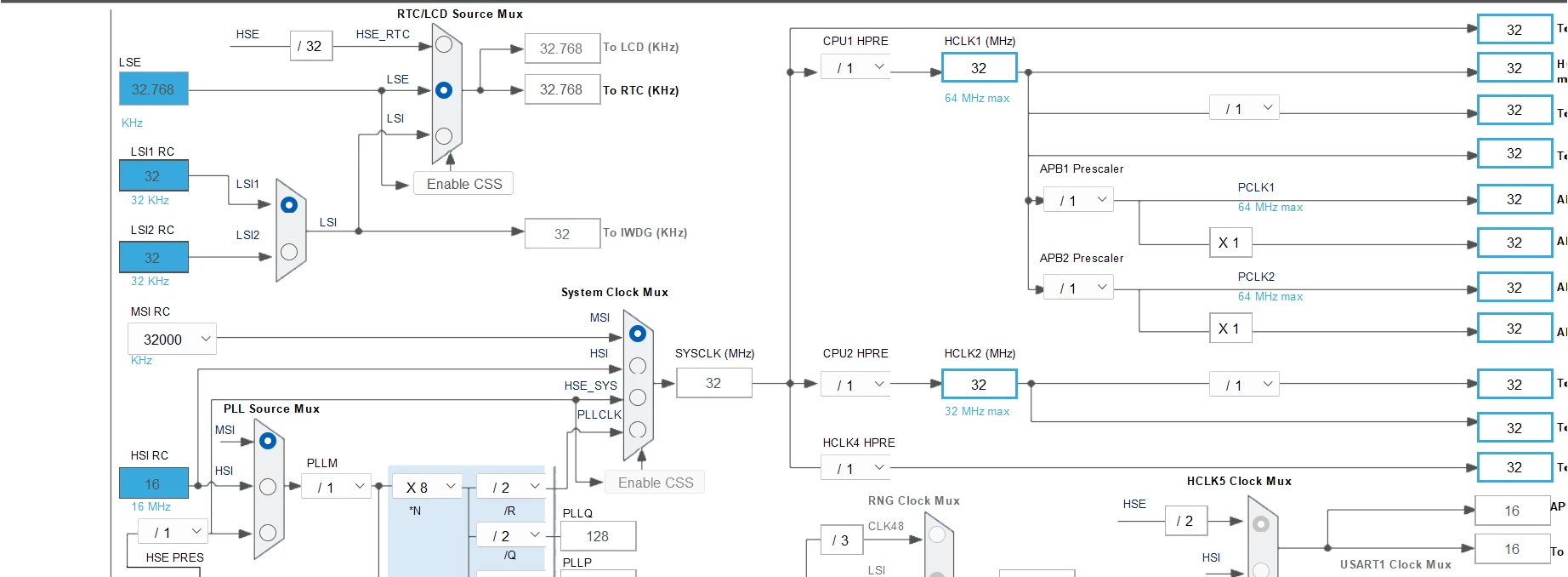

I made a breakout board using the STM32WB5MMG with SWD debugging.
I have confirmed that the SWD pins are working.
I have also set up HSEM, IPCC, RCC, RTC, RF, STM32_WPAN required but I can't detect the Bluetooth
The following are clock configuration.

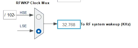

Sorry for the late response due to personal reason. The problem has been solved.
STM32CubeIDE Version: V11.1.0
For Firmware (V1.2.0):
stm32wb5x_FUS_fw.bin at address 0x080EC000
For Wireless (V1.15.0):
stm32wb5x_BLE_Stack_full_fw.bin at address 0x080CE000
Follow the guidelines on :
Remember to make sure that the wireless stack is started.
The problem I faced was the clock configuration for RFWKP Clock Mux. Previously, LSE was selected but the Bluetooth did not work. Thus, using HSE instead of LSE for the RFWKP works for me.
I am using STM32CubeIDE V11.1.0.
Is the following the correct configuration?
#if defined(STM32WB5Mxx)
 #define CFG_BLE_LS_SOURCE (SHCI_C2_BLE_INIT_CFG_BLE_LS_NOCALIB | SHCI_C2_BLE_INIT_CFG_BLE_LS_MOD5MM_DEV | SHCI_C2_BLE_INIT_CFG_BLE_LS_CLK_HSE_1024)
#else
 #define CFG_BLE_LS_SOURCE (SHCI_C2_BLE_INIT_CFG_BLE_LS_NOCALIB | SHCI_C2_BLE_INIT_CFG_BLE_LS_OTHER_DEV | SHCI_C2_BLE_INIT_CFG_BLE_LS_CLK_HSE_1024)
#endif
