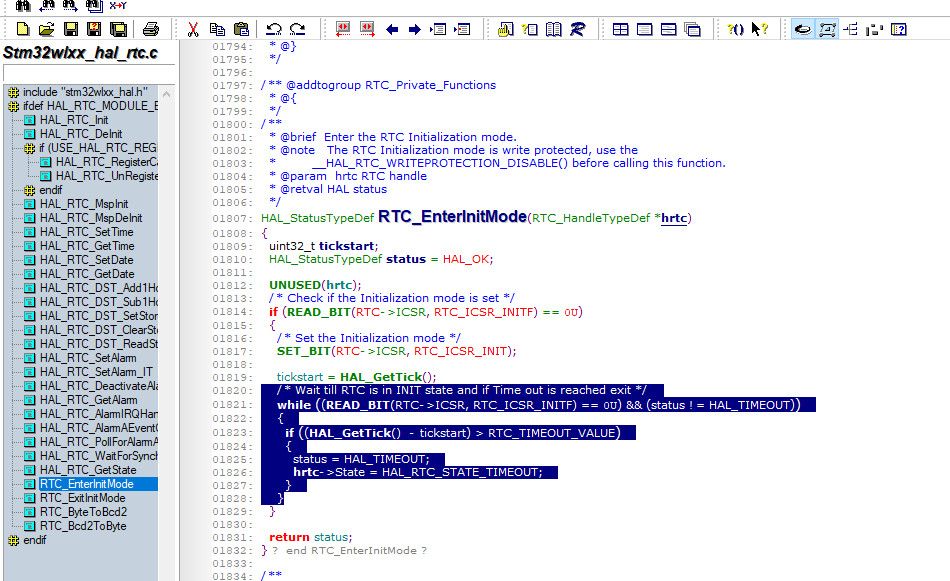

On the other hand, I found that:
If I select stm32wle5jb mcu in SubGHz_Phy_PingPong single core example and compile ,then flash fw to NUCLEO-WL55JC1 demo board , it keeps going round and round in follow source code line 1821. Do you know why?
TLi.4
Hi Mike,
My board is working well with SubGHz_Phy_PingPong single core example, I change RCC_RTCCLKSOURCE_LSE to RCC_RTCCLKSOURCE_LSI since my board has no LSE clk.
Thank you all the same.
