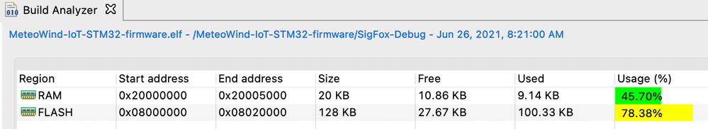

‎2021-06-25 11:35 PM
Same as Markus, but accessed different way: Window/Show View/Build Analyzer (I use STM32CubeIDE 1.6.1)

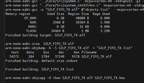

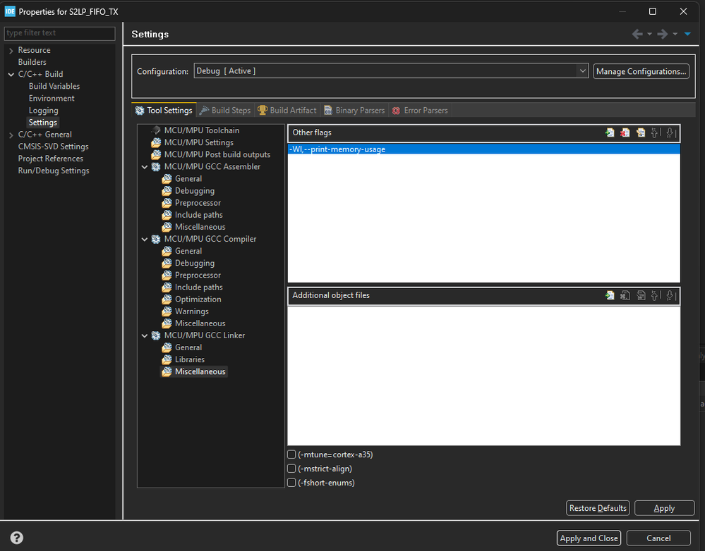

‎2024-10-03 1:36 PM
Hey,
you could add the linker option -Wl,--print-memory-usage to your project properties.
This will produce an output that looks something like this:
