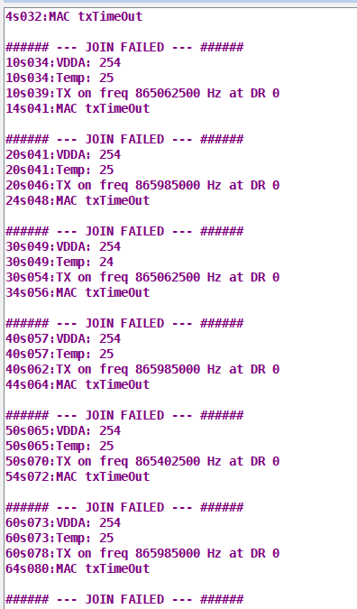

I am using a custom board for LoRa operations, where I have used RAK3172 which is based on STM32WLE5CCU6, the Official LoRa SDK from ST is working fine , now I want to develop the same program from scratch,
Issue: The module is joining the network server joining continuously(with an interval of 10s) after powering up, how can I program the module to send the join request for 5 or 10 times(just for example) and after joining it will send data to the server with particular time interval.

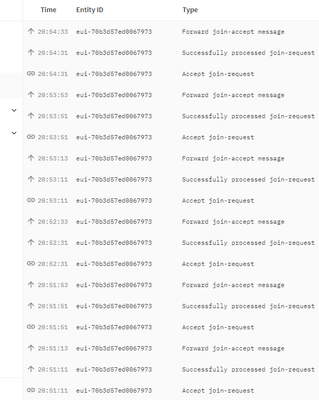

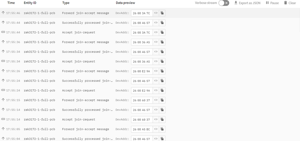

The module is joining successfully to the network server, as it can be seen
TTN server endTTN server endSo, I guess the Sub_Ghz / RF section is working fine, but the MCU section is not receiving any successful Tx return status from the RF sectiono, so it is trying to join again and again
Serial log of moduleSerial log of module
What could be the possible issue?
