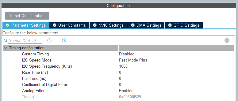

Hi Khalsi,
Once again thanks for your reply and support. In STM32CubeMX Some of the fields are not able to calculate like Rise & Fall times, and what is the impact of these two variables also we do not know and currently we keep it as zero's only.
If you have any other I2C example code integrated with specific application is useful to us.

You can check the I2C examples from :
\Repository\STM32Cube_FW_WB_V1.15.0RC2\Projects\P-NUCLEO-WB55.Nucleo\Examples\I2C
Download the STM32Cube MCU Package for STM32WB series :
‎2022-12-09 2:11 AM
Example description:
-I2C pins
-I2C Clock Source Frequency : 32 MHz
-I2C Speed Frequency : 1MHz
-Rise Time : 0 ns
-Fall Time : 0 ns

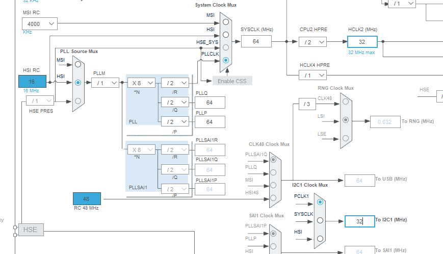

‎2022-12-09 3:09 AM
Hi Khalsi,
Once again thanks for your support and sharing the source code to us.
Almost code is the same except the Clock Source settings, in your code RCC_ClkInitStruct.SYSCLKSource = RCC_SYSCLKSOURCE_PLLCLK.
our code,
RCC_ClkInitStruct.SYSCLKSource = RCC_SYSCLKSOURCE_HSE.
but the Input Clock to I2C1 is 32 MHz Only, Mx settings also same. We will use Same Timing Reg value for our as well.
