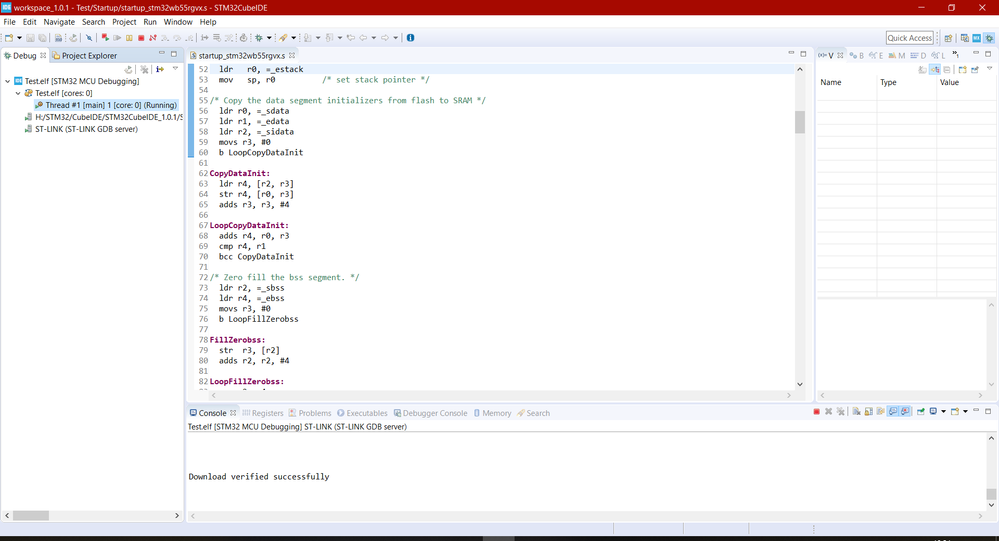

How can I handle situation , when even empty project stacks at Reset Handler without running code?
Code was generated in 1.02 version of CubeIDE for STM32WB55RG . Breakpoints were set on some places in main.c (f.e. Hal_Init() )
Huh??? Do you mean "STOPS" at reset handler? Have you stepped through the startup code? If so, what happens? Does a loop never end? Do you end up in a fault handler? Unless you have specifically provided code for fault handlers, getting a fault usually means ending up in an infinite "branch here" instruction just after the call to main.
‎2019-09-13 8:24 AM
I'd make sure the _estack pointer is correctly aligned and points to usable memory. I seem to recall a couple of complaints in recent weeks that _estack is set beyond the reach of available RAM (0x20005000 ??), check the .LD (loader script) vs documentation for the part in question.
‎2019-09-16 8:45 AM
loop don't even starts .
in STM32WB55RGVX_RAM.ld and STM32WB55RGVX_FLASH.ld - I got 0x20040000 - is that correct value?
‎2019-09-16 9:11 AM
Seems to be within scope based on a glance at the data sheet. Wonder if there is a specific clock enable for it?
