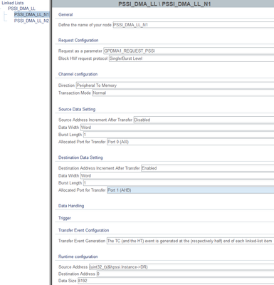

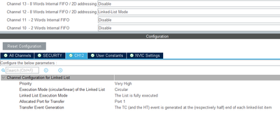

I setup GPDMA channel 12 for the linked list:
And here is the linked list with two nodes N1 and N2 configured exactly the same (except name):
Generated setup function in linked_list.c

In starting code I set destination address of N1 and N2 node link registers. Link registers are placed into AHB SRAM1 which is configured as non-cacheable with MPU.
Here's the start of DMA:
PSSI_DMA_LL_N1.LinkRegisters[NODE_CDAR_DEFAULT_OFFSET] = (uint32_t)buffer;
PSSI_DMA_LL_N2.LinkRegisters[NODE_CDAR_DEFAULT_OFFSET] = (uint32_t)buffer + 8192;
HAL_DMAEx_List_Start_IT(&handle_GPDMA1_Channel12);
If you wonder why access directly - that's what I plan to do in callback and I need to switch buffers a lot of times anyway. Re-building linked list seems a bit too much. For simplicity reasons I skip the HAL return functions check code from forum.
PSSI is enabled by this time by CubeMX generated code. I see correct values in PSSI DR register with debugger.

Another, and currently even bigger problem is that the linked list does not circulate. By adding a simple incrementing integer into transfer completion callback and printing it out in the main loop I see only 1 and 2. Using debug breakpoints seems to break transfers, that's why I used non-invasive method. I do not get DMA error callbacks. I have seen data reach RAM, but not always.
Reference manual RM04777 chapter 12.4.3 "GPDMA circular buffering with linked-list programming" is creating more questions. It seems to suggest that only the second node should loop and half-transfer completion interrupts should be enabled. I don't grasp that idea...

To make the LL circular, there is an "circular mode" option to enable in cubemx system core gpdma1.
As for a basic linkedlist, each node stores the address (the LSBs) of the next one, in the circular mode, you just need to specify the first node address on the last node. Be sure to enable the ULL bit in the GPDMA_CxLLR register. it indicates the hardware there is a next node and enable the system to fetch the address of the next one.
