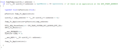

Hey everyone, I am using STM32WB55RGV7 processor. At the beginning of my bootloader program
if (((*(__IO uint32_t*)address) & 0x2FFE0000 ) == 0x20000000) // if there is an application at the APP_START_ADDRESS { typedef void(*pFunction)(void);
pFunction Jump_To_Application;
uint32_t jump_address = *(__IO uint32_t*)(address + 4);
Jump_To_Application=(pFunction)jump_address;
__set_PRIMASK(1);
SysTick->CTRL = 0;
__set_MSP(*(__IO uint32_t*) address);
Jump_To_Application();

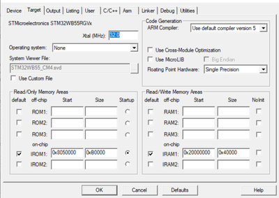

I use the function and so my program jumps to address 0x8050000. When I jump to this program, I start with the commands

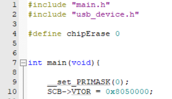

__set_PRIMASK(0);
SCB->VTOR = 0x8050000;
and I do not have access to my M0 core after this point. Before using the Bluetooth feature, I was starting the program from address 0x8050000 as I wanted and after that I had no problems. But after jumping, I can't access the shci functions at all and the program crashes. My problem is

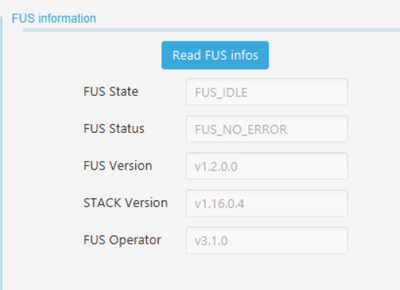

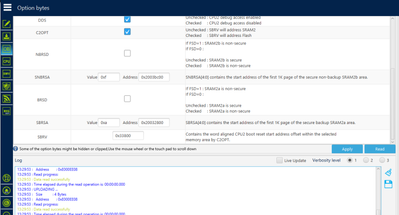

Have you updated your FUS and stack? If so, have you clicked in the "start wireless stack" button? If so, please share your FUS and stack version (a screenshot from CubeProgrammer will be a good idea) and your option bytes values. Finally, tell me the source of you .bin FUS and Stack files (the version if STM32CubeWB).

Could you please update the FUS and STACK, then click on the button "start wireless stack". After that, upload one of our ST examples and test if ot works or not. If you still have the problem, please share the values of the SBRV and SFSA option bytes. Also, read the content of the address 0x5800040c. Finally, read this wiki (specially the FAQ part).

I updated Fus and Stack and I click on the button "start wireless stack".
As I said before, I am having trouble because I made the starting address of my M4 kernel 0x8050000. The starting address of my M0 core is probably old so the bluetooth feature cannot start. I have a scenario like this. In my bootloader software, if I receive a broadcast from a bluetooth sensor (bluetooth feature is working), I jump to the 0x8050000 address with my JumpFwApp function. After this jump, after the __set_PRIMASK(0); and SCB->VTOR = 0x8050000; operations, my second software works successfully. However, my bluetooth feature does not work. If I try to run any of the APP_BLE_Init and schi functions, it loops. Because my M0 core does not work.

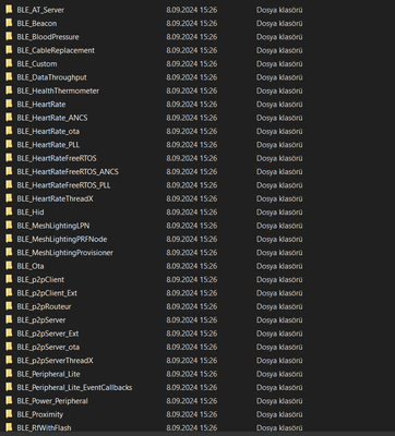

Try any example from our ble example on the STM32CubeWB V1.20.0. and perform test. Than send all data that i've asked for on the 3rd comment.

Sorry, I always have problems building in sample projects. I think we won't be able to find a solution this way. If we can't find a solution other than what you said, thank you anyway. There is just one thing I am curious about. I am making the settings via Keil. It is said on the internet that the starting address of the M0 core can be changed. I couldn't find a way to do this, or it was said that I can change the starting address of the M0 core from the option bytes options. Is there such a method?
