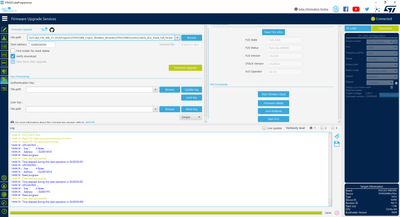

I can't seem to get any of the samples to connect using the ST BLE Toolbox or ST BLE Sensor applications.  Here's what I have:
Uploaded the latest BLE full stack:

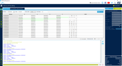

Uploaded the BLE_HeartRate_reference.hex file:

After Firmware and stack upgrade, did you started the wireless stack (using the button available on Cube Programmer FUS interface). If no, please do it and try again.

I thought I had but these steps seemed to get it working:
In Cube Programmer
  1. Connect to device
  2. Start FUS
  3. Read FUS
  4. Start Wireless Stack
  5. Program the .hex file
  6. Disconnect and power cycle the board
  7. Start ST BLE Sensor, board shows up!
This was successful, thanks for the assistance.
