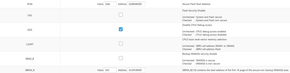

Can you share the option bytes values of your board?
Best Regards

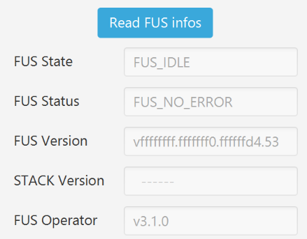

In this scenario, FUS version is different from 0.0.0.
In first, there is version number like this, after I try to recover it, it changes to 0.0.0.
Do you need other option bytes?

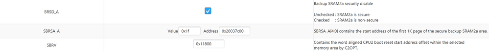

According to SBRV option bytes value, the FUS is not running, you should start the FUS before reading the version. Can you add a screenshot of ESE option bytes?
Best Regards
‎2023-05-22 5:24 AM - edited ‎2023-11-20 5:48 AM
ESE is checked.

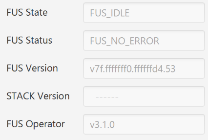

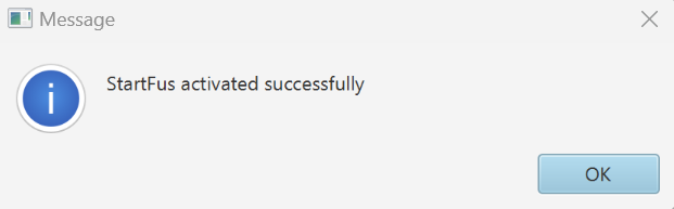

When I press Start FUS on STM32CubeProgrammer, it shows me
And after I press Read FUS infos, it shows me following info, and SBRV is 0x11800.
‎2023-05-22 5:26 AM
In my previous message, FUS version is different from in new message.
I think there is a problem about FUS, so I want you to send me FUS binary file.

In my previous I made a mistake, SBRV at 0x11800 indicate that the FUS is running. Unfortunately, I can't share a FUS binary file. Which version of STM32CubeProgrammer tool are you using? And which interface are you using to connect board?
