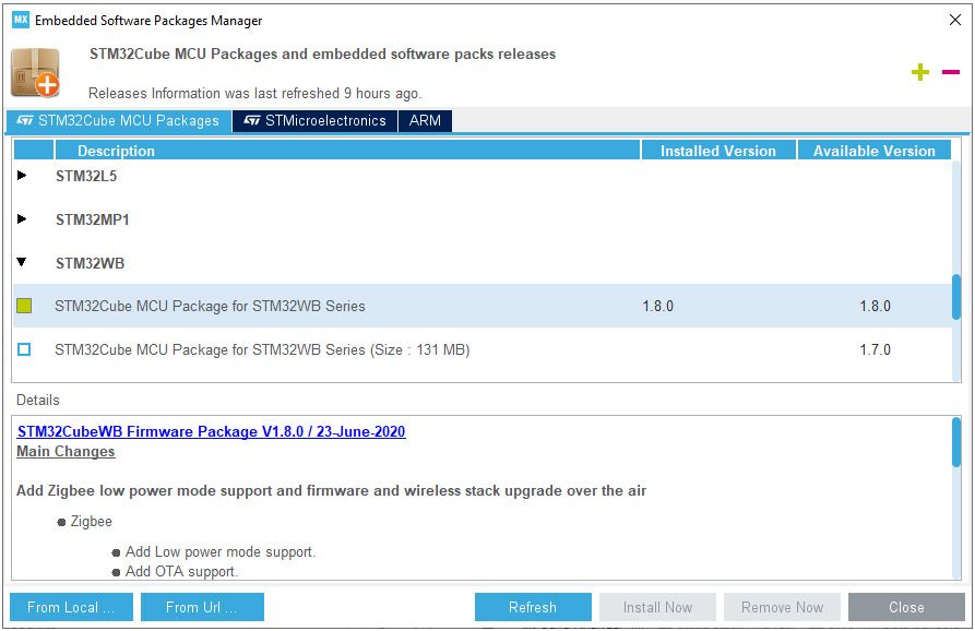

In STM32CubeIDE; can you remind us how and where to verify we are running the latest CubeWB FW package please. You mentioned that FW package v1.9 is out and I did not know that, neither wouldn't be able to tell if STM32CubeIDE is using the latest APIs from 1.9.
What is the ST guidance on remaining updated with the STM32WB? or is this something that is carried out automatically via background downloads from/by STM32CubeIDE?
Thanks
Getting address error. Please see screenshot.
Same error for other addresses also, 0x0803e000 and 0x0807e000.
ok, I get it, I think. 1.9 released on the Github repo, however not yet supported within STM32CubeIDE. Is this correct?
ps. just found out how to manually check for package updates. Spoiled by the automatic updates of CubeIDE, I got lazy in checking I'm guessing ;)
