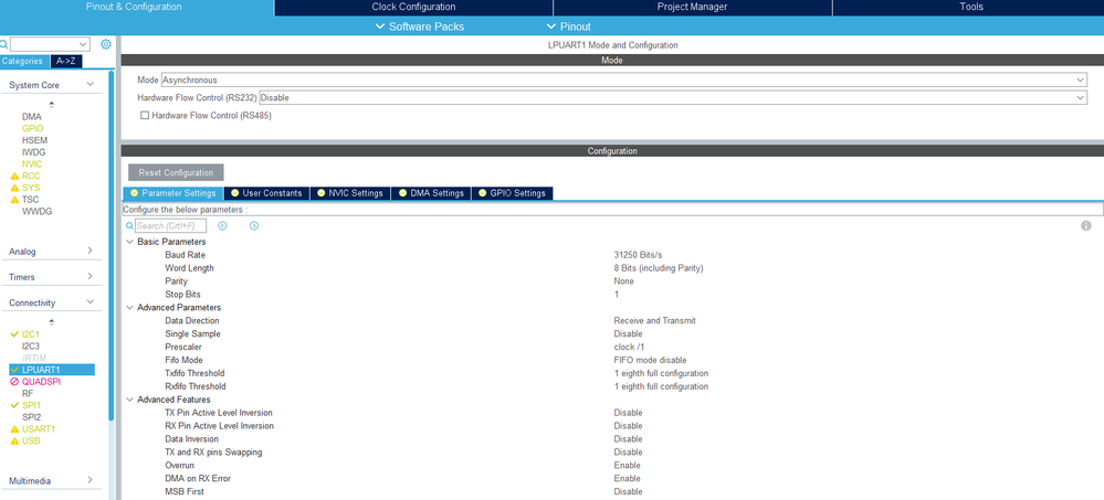

Unfortunately, I can't seem to get it to call the HAL_USART_RxCpltCallback function . . . I assume my issue is I missed something pretty straight forward (like starting the LPUART interrupt or something to that effect). I have it setup to have a global interrupt for the LPUART with priority 2.
Full disclosure, I did use the *.ioc file to setup most the parameters so it could be a setting issue in the *.ioc file. Regardless, here's my initialization function (if it helps):

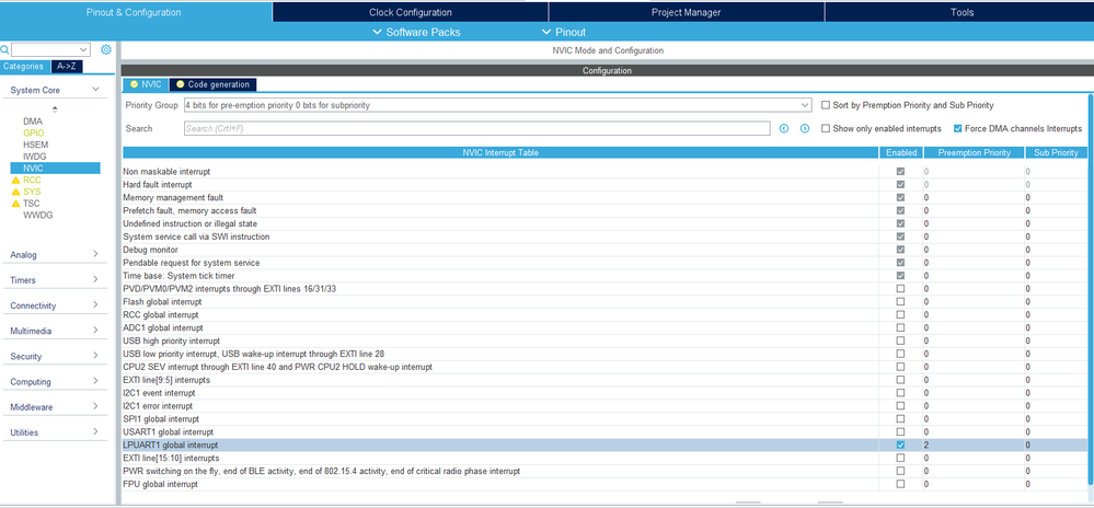

It didn't make it to that unused portion as well. Based on this, all signs seem to suggest there's an issue with setting up the NVIC for the UART, right? Not sure what else it might be if it's not opening up either of these. There aren't really too many settings to setup though so I'm a bit confused as to why that might've caused the issue . . .
0693W000005A70wQAC.png0693W000005A70rQAC.pngAm I missing something?
Thanks for the help!
