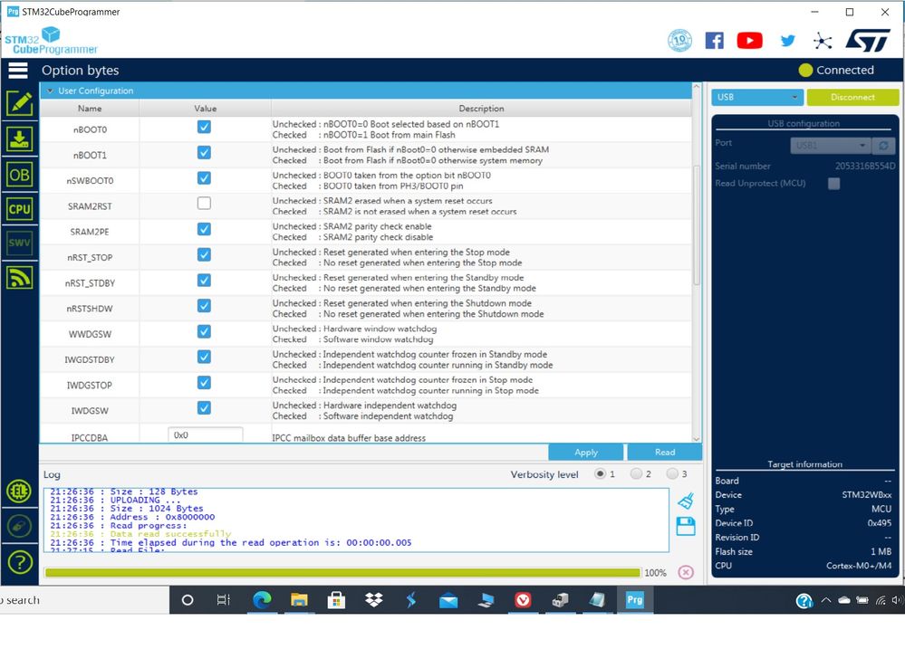

Parmin Nayani
Hi Remi QUINTIN,
Here are the option bytes.
RDP - AA
BOR_LEV - 0
User configuration screenshot is here -
0693W0000059MjLQAU.jpgSFSA - 0xf4
Should I post other options too? Thank you.
Remi QUINTIN
So obviously there is no RF stack programmed on the dongle.
So first perform a mass erase (it should generate an error that you won’t consider) or erase all sectors up to the 0xF4 one.
Then program the RF stack. If it is successful,  check the SFSA option byte. It should be set to 0xCB if the RF stack is correctly installed
If it is, just finalize your configuration, programming the application at the address 0x08000000.
It should work.
So perform a mass erase (this will generate an error that you should not consiere) or you erase all ectors up to the 0xF4 one and above.
