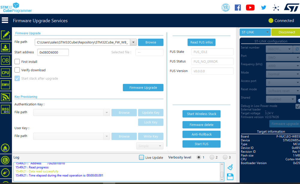

Hello I am using stm32wb55 nucleo i am tring to delete the firmware but it shows error
C:\Program Files\STMicroelectronics\STM32Cube\STM32CubeProgrammer\bin>STM32_Programmer_CLI.exe -c port=SWD -fwdelete

‎2021-08-13 3:22 AM
Hello Imen,
thank you so much for your quick response
As per your suggestion i updated the STM32CubeProgrammer and run it in cmd prompt so get same error..!!
even in software it shows
fus state: fus_idle
fus status : fus_no_error
fus version : v0.0.0.0

‎2021-08-13 3:27 AM
Did you try "connect under reset"?
Thanks
Imen
‎2021-08-13 3:36 AM
yes...like by keep pressing reset button after connecting usb need to release the button right..??
i tried like that
‎2021-08-13 3:39 AM
here board is connecting proprly its detecting in STM32CubeProgrammer tool and cubeIDE so i can upload the example program also..so no connection issue
the problem is not possible to delete the firmware

‎2021-08-18 1:55 AM
Could you download all the option bytes?
How old is your Nucleo board?
