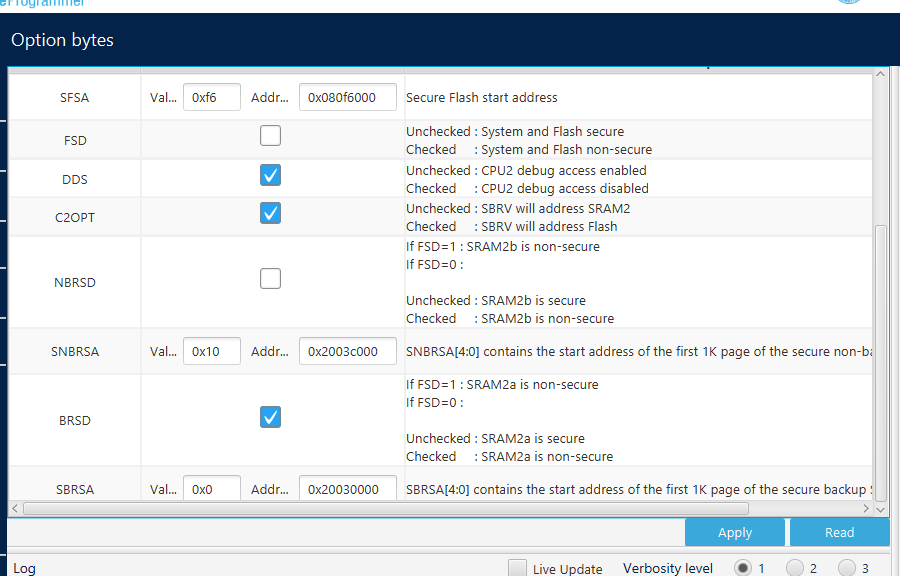

Can you please share a screenshot with SFSA and SBRV OB which are part of the security configuration as mentioned by Remi QUINTIN?
Houda

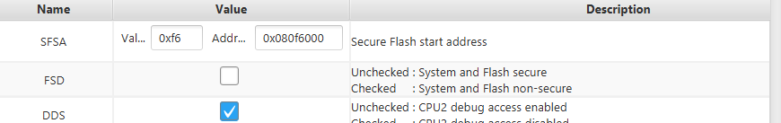

i have another STM32WB DK which is working so i connected and observed that the value of SFSA and SBRSA is differ from the current (which has issue) DK.
so i tried to change the value so it gave the error "option byte program failure"
Remi QUINTIN
The SBRV value is still missing but I have enough info with SFSA = 0xF6 to say that the FUS has never been updated on this board as this address is the one of the very first FUS version v0.5.3. At the opposite, the pre-installed FW has indeed been deleted.
From this constatation, I can say that you will never be able to upgrade the FW with this FUS version. You need first to upgrade it to FUS v1.0.2 first and then to the latest version v1.2.
Then you will be able to program the FW stack on your board.
So we have to focus first on the upgrade to FUS V1.0.2.

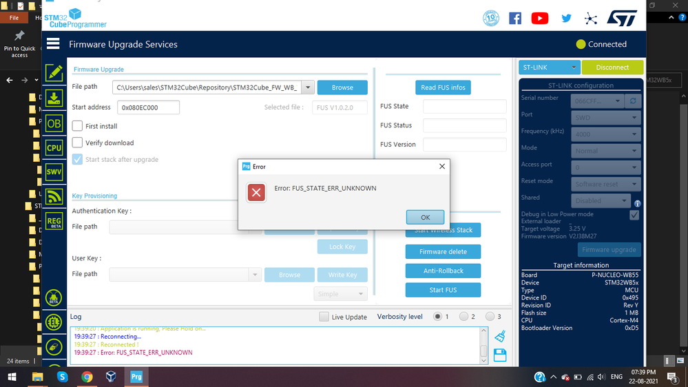

Ra.1
sorry for late response, i tried with both the files which you have suggested stm32wb5x_FUS_fw_for_fus_0_5_3.bin, stm32wb5x_FUS_fw_1_0_2.bin
but getting same error as shown in below screen shot
0693W00000Dq1d0QAB.png0693W00000Dq1bdQAB.png 19:34:15 : Old Firmware delete ...
 19:34:15 : Warning: Option Byte: nSWboot0, value: 0x0, was not modified.
 19:34:15 : Warning: Option Byte: nboot0, value: 0x1, was not modified.
 19:34:15 : Warning: Option Byte: nboot1, value: 0x1, was not modified.
 19:34:15 : Warning: Option Bytes are unchanged, Data won't be downloaded
 19:34:15 : Succeeded to set nSWboot0=0 nboot1=1 nboot0=1
 19:34:15 : Memory Programming ...
 19:34:15 : Opening and parsing file: 0x495_FUS_Operator.bin
 19:34:15 :  File     : 0x495_FUS_Operator.bin
 19:34:15 :  Size     : 8 KBytes
 19:34:15 :  Address    : 0x08000000
 19:34:15 : Erasing memory corresponding to segment 0:
 19:34:15 : Erasing internal memory sectors [0 1]
 19:34:15 : Download in Progress:
 19:34:15 : File download complete
 19:34:15 : Time elapsed during download operation: 00:00:00.273
 19:34:15 : Application is running, Please Hold on...
 19:34:22 : Reconnecting...
 19:34:22 : Reconnected !
 19:34:22 : Error: FUS_STATE_ERR_UNKNOWN

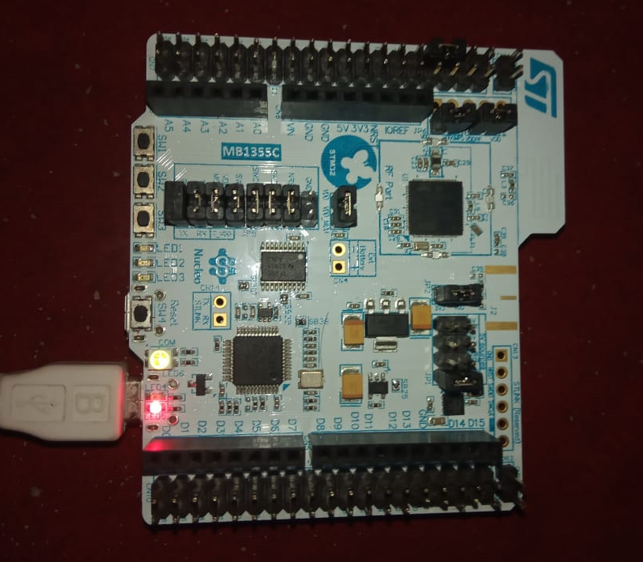

just for confirmation check my board connections as follows
Remi QUINTIN
Strange! Could you give us the value for the SFSA and SBRV option bytes?

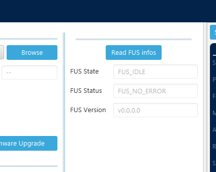

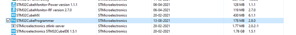

Could you move to CubeProgrammer 2.8 and read the FUS value with this version?
You may have to press the "READ FUS version" button twice to get the version.
1) Could you give us the value for the SFSA and SBRV option bytes?
A: i can find SFSA but SBRV not there in that list
2) One point above is the fact that it seems the FUS upgrade looked good, but the SFSA value is still 0xF6.
A: actually at that point i clicked just "START FUS" option but i did not pressed "UPGRADE FIRMWARE" option in it so in log that shows just fus_started_successful
3) Could you move to CubeProgrammer 2.8 and read the FUS value with this version?
A: yes i am using same version
4) You may have to press the "READ FUS version" button twice to get the version
A: 0693W00000Dq66pQAB.png
Remi QUINTIN
1) So what is the value of SFSA? Still 0xF6?
Note that the SBRV option byte is in the same "secure" window but you may have to scroll the window down a bit to see it appearing.
2) OK understood.

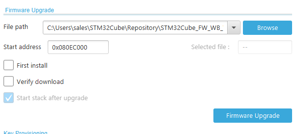

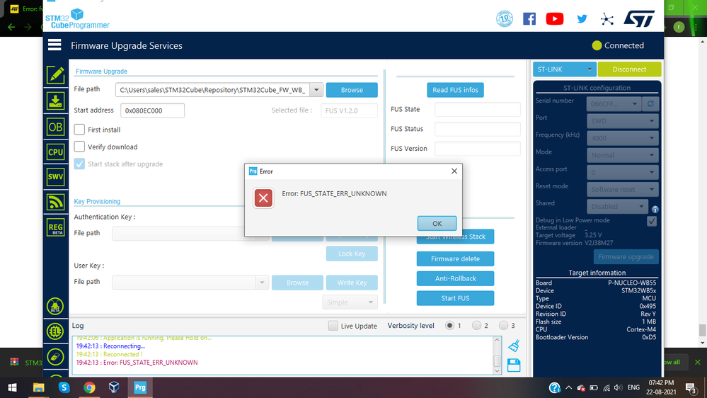

Could you show me the command you sent to upgrade the FUS with stm32wb5x_FUS_fw_for_fus_0_5_3.bin or stm32wb5x_FUS_fw_1_0_2.bin files?
The addresses should be 0x080EC000 for both.
Note that you may only use stm32wb5x_FUS_fw_for_fus_0_5_3.bin file to upgrade the FUS to the latest version.

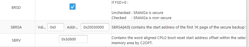

1) Yes i got the SBRV  value as well as SFSA see*2
2) No...i am not updating using cmdprompt just i am clicking the firmware upgrade option see *1
image: *1
image: *2
Remi QUINTIN
For the FUS upgrade , you should uncheck the "Start stack after upgrade" button. I see it seems not active as there is no FW installed but who knows.
SFSA and SBRV option bytes are consistent. The load address is also OK.
